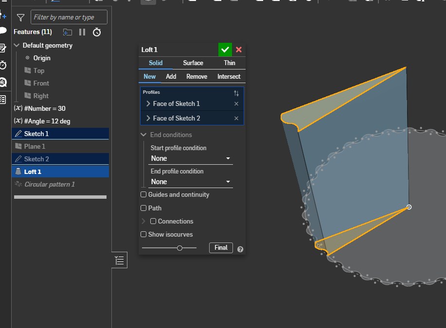

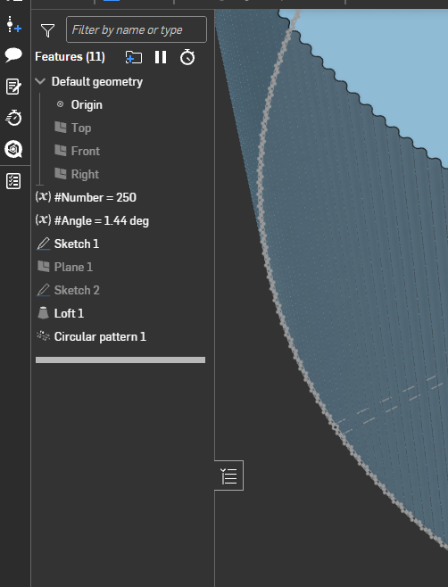

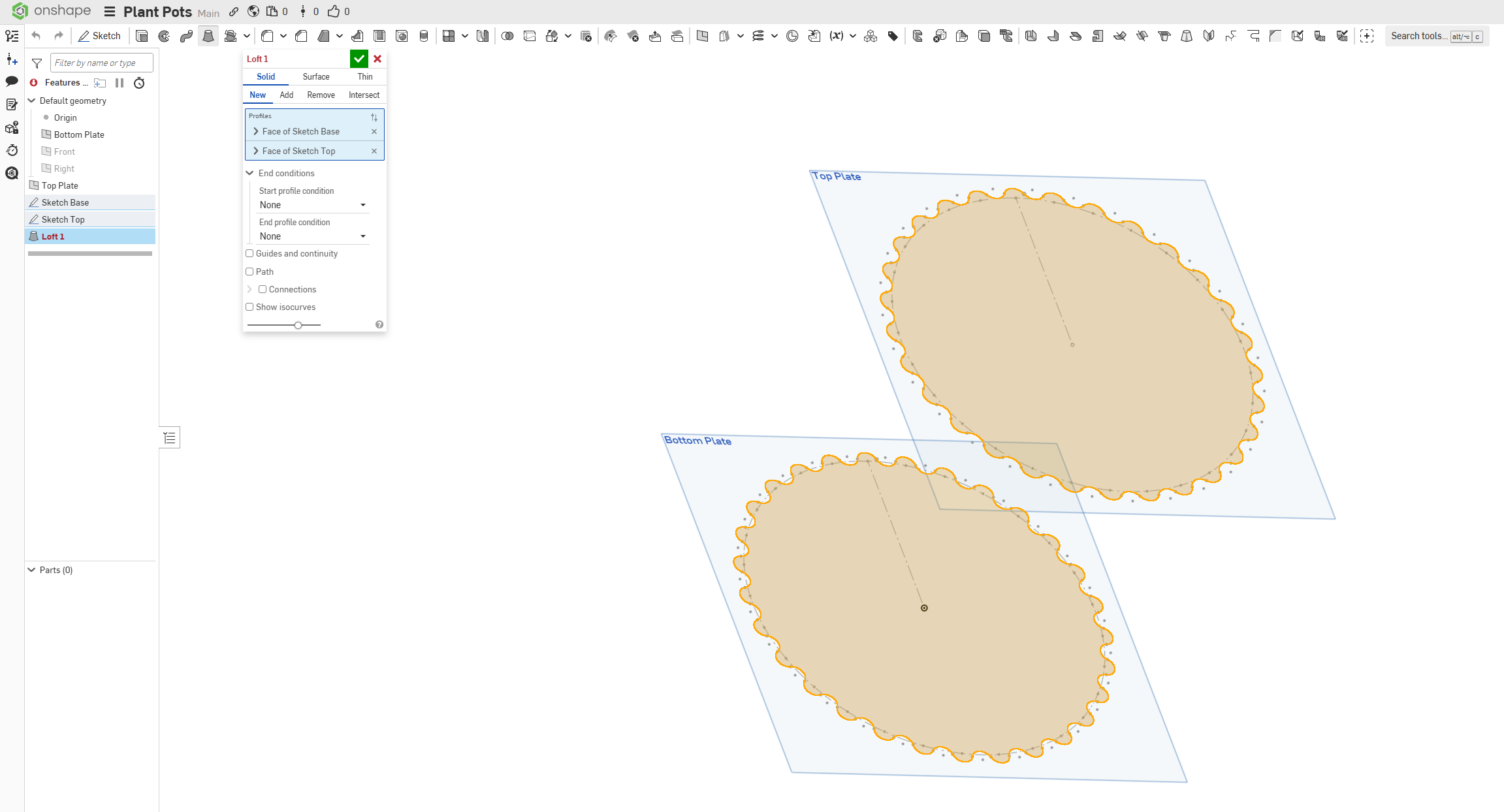

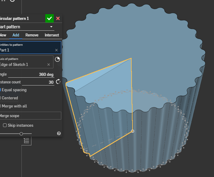

So I'm trying to make some plant pots that I can 3d print at home on my bambu, and I can't pin down why this loft isn't happy. the two sketches are the same, excpet that the top one is a little larger. Both are fully parameterized, created by usind a pattern that repeats 2 semicircles about the central point. Even if I make the curves very tame, the loft fails. Any help or advice would be appreciated.
