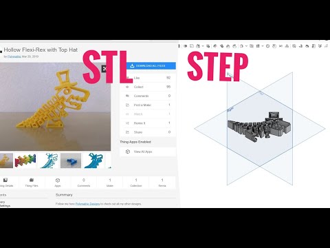

    janko_mrkvajanko_mrkva Member Posts: 5
    I found a way to edit stl in onshape. https://youtu.be/bHa8hCAoTpc
