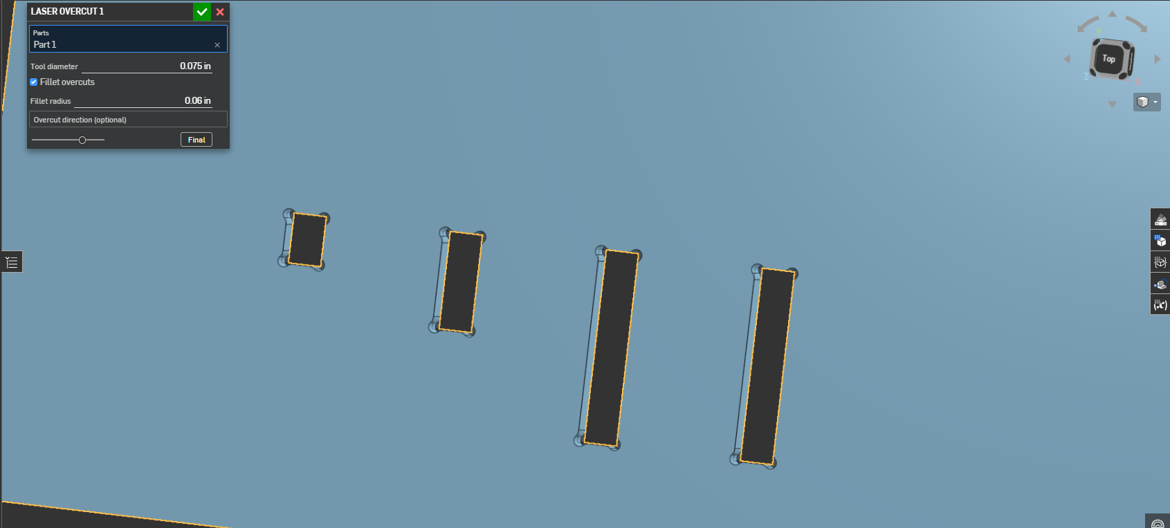

Full disclosure - I'm a fixture / tooling designer, not a software developer. I iterated a custom FS last year using AI. I started with the CNC overcut feature that Hendrik_Kueck posted here in 2023 but for my work flow, what I really wanted was an overcut feature specifically for a Laser. To that end - I wanted the overcut to be "inset" from the corner a little, so that the transition wasn't so severe. It's default now, is to inset the cut tool by 1/2 the radius, and I use this thing constantly. Best feature is that it will find all the internal corners of a given part automatically.

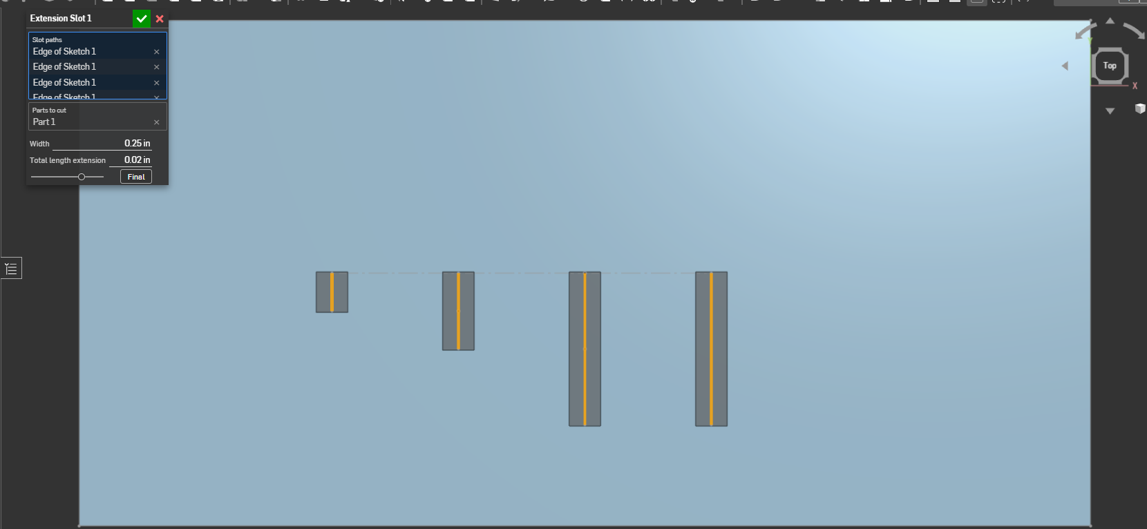

To compliment this work flow I took the slot feature from the FS tutorial and added the ability to symmetrically "extend" the slot by a user defined amount and also the ability to select multiple sketch lines in one feature. Just sharing here in case anyone else would find these useful.
