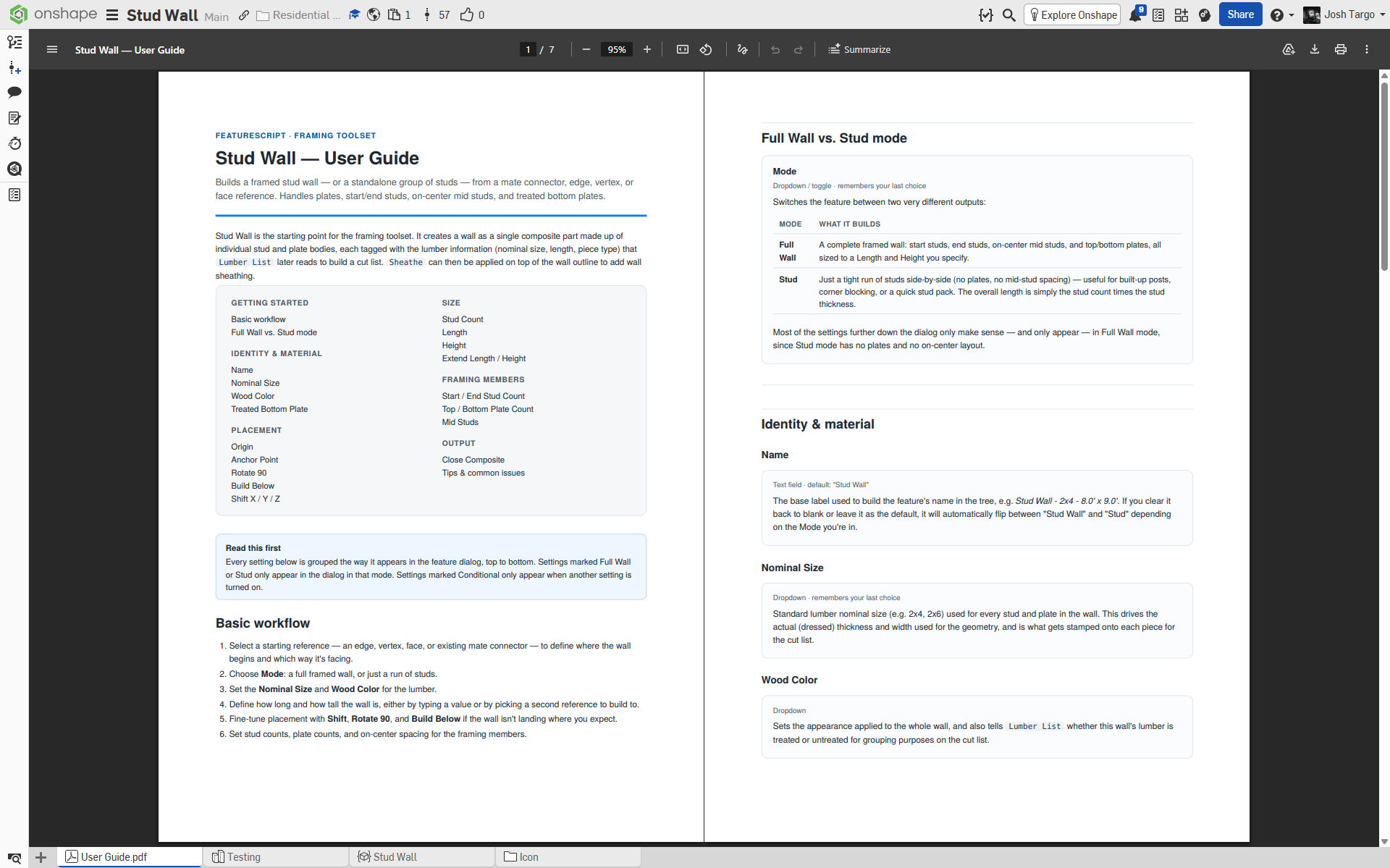

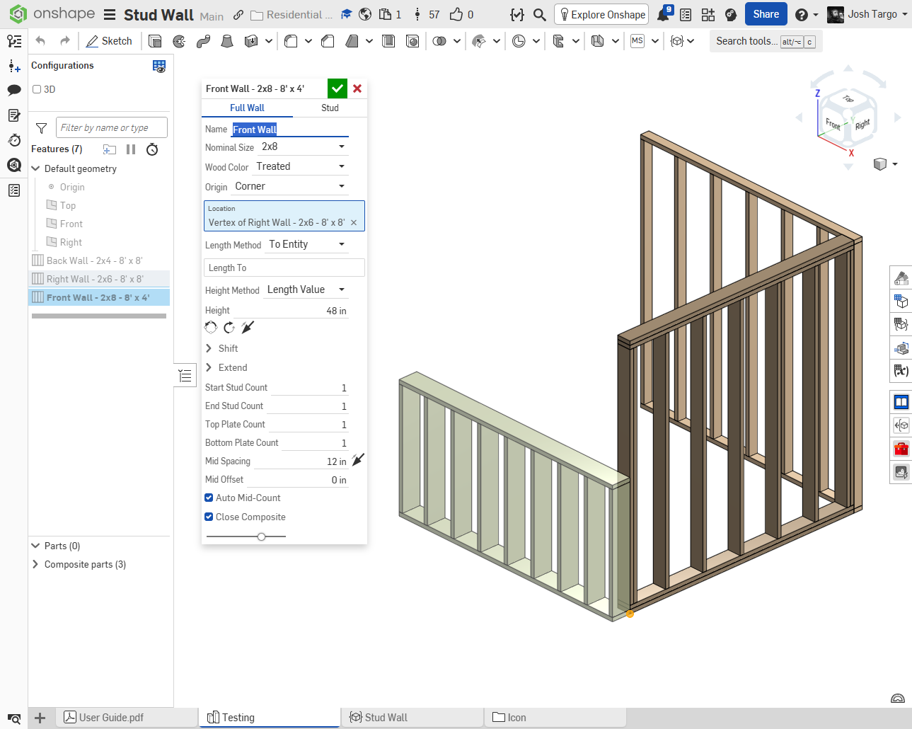

I've been working on Stud Wall for a while and it feels pretty stable now. I had some assistance from Claude in the code, and it wrote the full User Guide (thank you @GregBrown for giving me the idea to ask AI to do that part).
I'll soon publish Sheathe and a console-output version of Lumber List. I also have Door almost ready to go and will get Window working - both of these will insert and cut for rough framing only, no actual units yet.
I know there's not a lot of architectural users here, but if anyone wants to try this out, I would appreciate feedback on bugs, features, improvements, UI, etc.

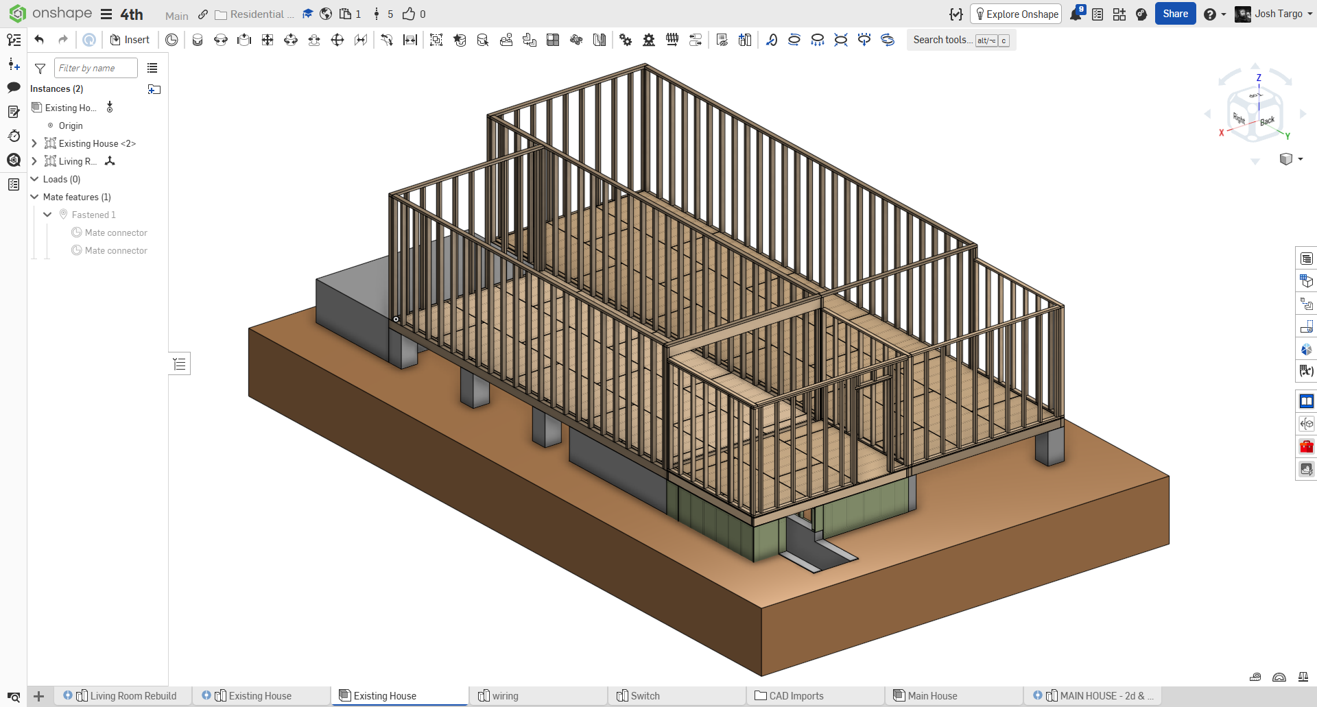

You can see an example of the full suite on my 4th st project.
