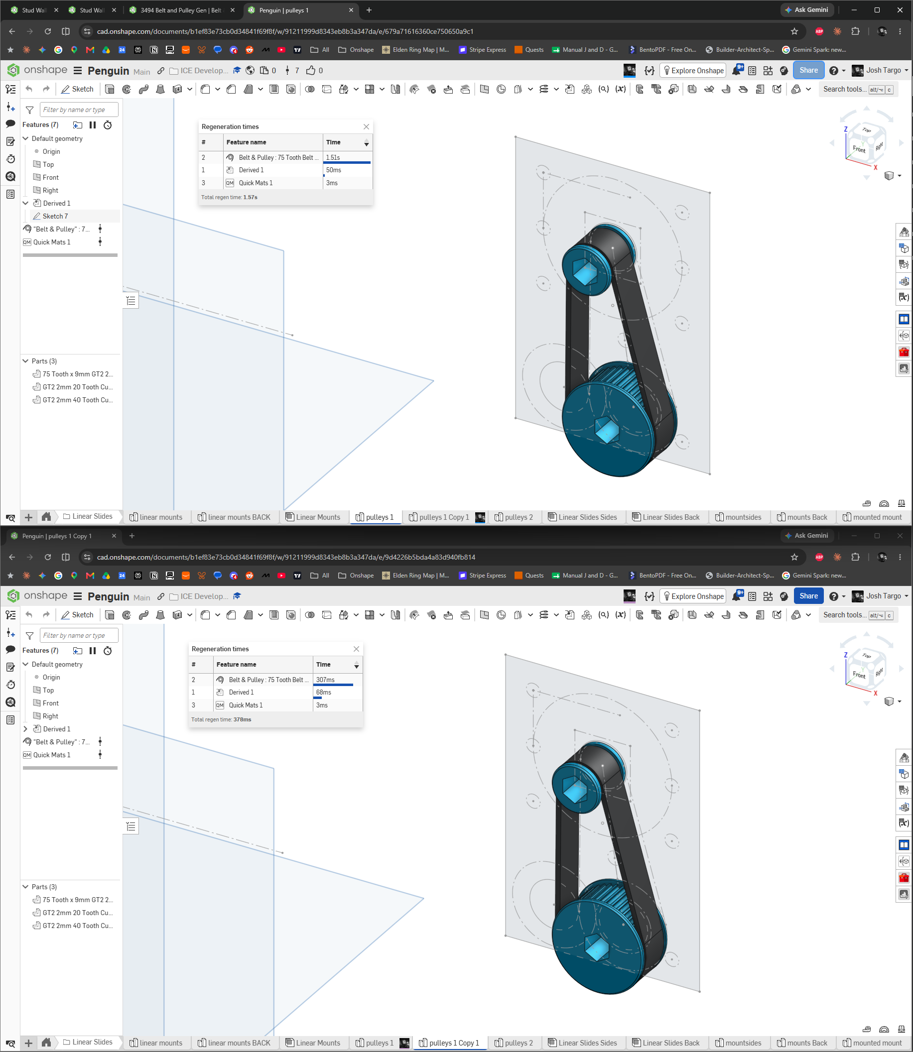

two identical part studios, wildly different regen times. why?
joshtargo
both of these are in the same document, the lower, faster one is a pure duplicate of the upper, slower part studio. the belt and pulley gen is 1,5s in the first, but 300ms in the second. why could this possibly be?

    The belt&pulley custom feature uses build functions that regenerate other part studios. The first time around they were actually regenerated (hence the 1.5s regen time) and the second time, a cache was used, so they only needed to be brought in, not regenerated (hence the 300ms regen time). If you were to, say, add a feature at the beginning of the first part studio, you should see the shorter regen time there too.

    @ilya_baran if i were to rewrite it, i should try to do it without an instantiate call? is there any way to hard code a step file when using opimportforeign or do you have to make the user select the file?

    @Caden_Armstrong I found that importing with opimportforeign can be much faster than deriving sometimes, but i couldn't figure out a way to hardcode the file choices into an enum so the user doesnt have to navigate to the document and pick a step file. is this possible? it would allow a starting base of fairly complex geometry without the overhead of building it.

    @joshtargo You are correct that opImportForeign is faster, but it should be only a very slight difference compared to a part studio with just one import feature. I suggest keeping the custom feature and the part studios it brings in all within one workspace to make sure that std versions stay in sync.
