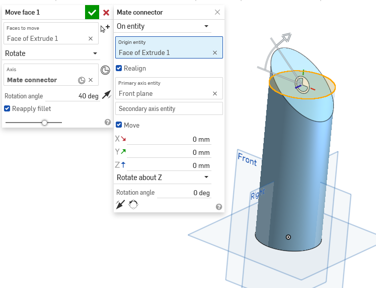

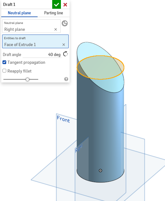

    In any event to the OP, you can study up on how to use on shape through the learning center to get ideas. but a few other ways (besides sketch, extrude/remove already suggested) to accomplish that would be draft tool, move face tool.

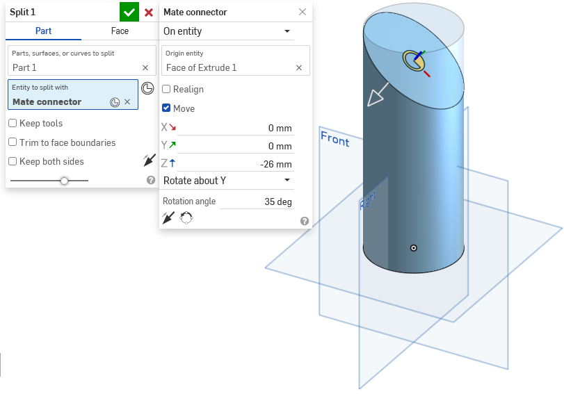

  • robert_scott_jr_
    Hey Kevin, as stated in previous posts, there are a lot of ways to get the angled surface on the cylinder. I used a Mate Connector. Mate connectors are extremely versatile tools. I find my most frequent use of the mate connector, outside of an assembly, is as a sketch plane. One use of a Mate Connector is as a Split entity.
    In this document, after selecting the Mate Connector tool, I hovered the mouse pointer around the cylinder (previously created) and implicit mate connectors started showing up. I picked the one at the center of the cylinder. If you take a look at the dialog within the mate connector feature, you'll see I offset its original location and rotated it; I just picked some random values for demonstration purposes. Afterward, I used the mate connector to split the cylinder.

  • MDesign
    Here are 3 ways. A certain level as assumption has to be done becuase its impractical to assum everyone is asking from the same base knowledge level and its not often clear what the specific end goal is of the OP question.
