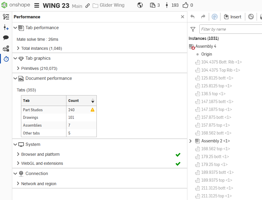

    I currently have a document with 1031 instances in the assembly and I need to mirror it and change it….whereas I have learned to build new part studios in context and derive into the new part studio any parts I want and change the name in order to edit specific parts and then insert the new named part into the assembly and perhaps delete the old named part….I am not sure this approach is the best to follow for the mirror of the whole assembly.
    Even breaking the large assembly into subassembly seems to me would add regen time as perhaps the software would need back into the old large assembly and then split off into the subassembly to make any change.
