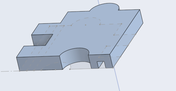

I need to invert a set of parts, equivalent to the Mirror function. But without creating new and deleting old, and losing the names of the parts involved. I don't care it the part moves in the process or flips in place.
I've been trying to scale across the z-axis with a -1 scale factor, but it's turning red… Is negative scaling not allowed? Any other options?
Thanks.

    I don't want it smaller. I was (perhaps mistakenly) told that using scale factors like (x: 1, y: 1, z: -1) is a pretty standard way of converting a 3D part into a mirror of itself. Scale factors are coordinate multipliers. So multiplying only the z-coordinate by -1 would flip the part across the z-axis for a 1-step flip of the part. I only mentioned that to show that I had attempted things before asking for help. I see that this is more of a Math thing than a CAD thing though. But that's what I'm after.
    I'm literally just looking for the part equivalent of the "flip vertical" function from the text editing interface. For example, if the transform feature had a "mirror" option where you didn't have to create an extra part… Or if the "Mirror" function had a checkbox for "Mirror in place" to tell it not to make an extra part.
    Below is a link to a simplified example. Given the example part, I'm looking for a result where the only visible change after applying these changes, is that the groove in the part moves from the top to the bottom.
    https://cad.onshape.com/documents/46e06838d28589243a2d6345/w/1e024f865c5e8ac1fe0b8f94/e/3f571e55f70a1f1487f9f035

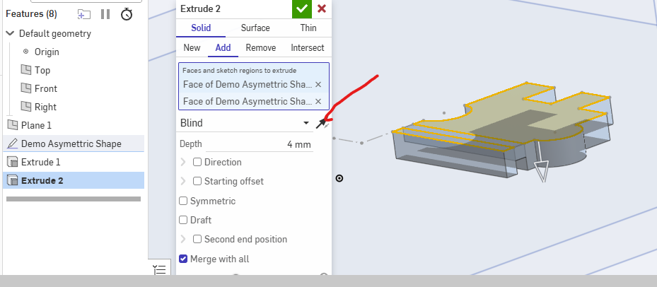

    Here are some samples using mirror/delete, transform/rotate, leftyflip, change extrude direction.
    All seem to work well which gives you some choices. None use -1 as a coordinate as I could not think of a way in Onshape unless it was done with a feature script. Change extrude direction looks simplest to me.
    One thing I would note. I typically leave such things in place and set final position at the assembly. If a left and right are needed then just mirror and leave 2 parts.
    https://cad.onshape.com/documents/1feeefe395768088071300a4/w/bca5b3d70ab3629935e028c7/e/b741521641c6ef4681827dd5
