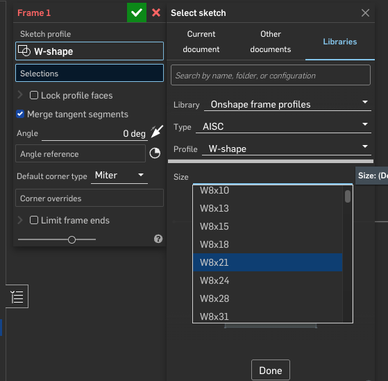

Check out the built-in Frame tool: https://cad.onshape.com/help/Content/frame.htm
There are I beams in the featurescript just not U.S. designations like W8x20. You can add your own profile library under the custom tab.

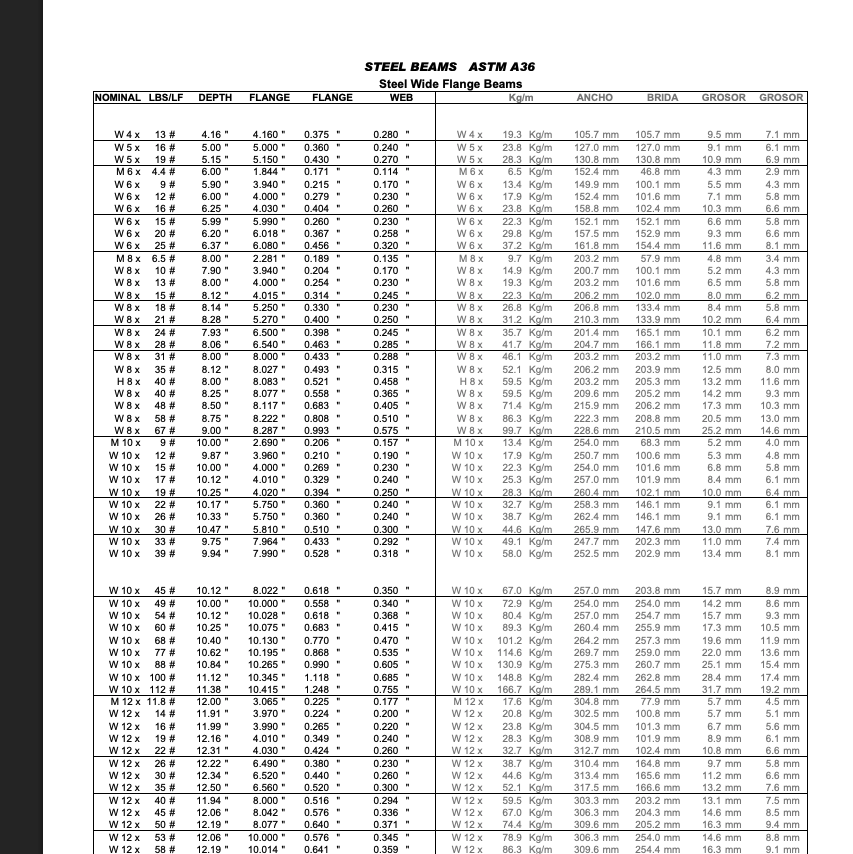

You don't see that one on most sheets. But you can find many of the U.S. designations in Onshape.
@wayne_sauder Yes. I was just pointing out that there are some I shapes available for @colin_king506 . Frames tool is going to be the go to tool since its native but the beams script is interesting and worth looking at.
