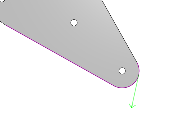

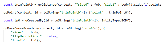

I have this code which literally makes a point on the curve i want to trim:

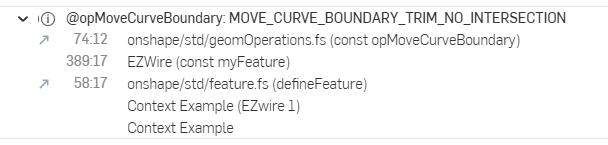

but I get this error:
Unless … the parameter for the point is more than 0.5.

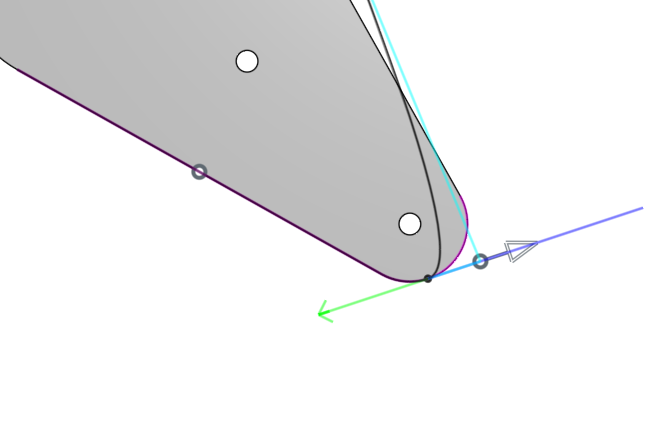

Debug shows the point is where I think it is, at the base of the arrow.
parameter 0.28:
Parameter 0.68:
in addition, helpPoint has absolutely no effect on which side of the curve is removed, nor does flipHeuristicssome of the time.

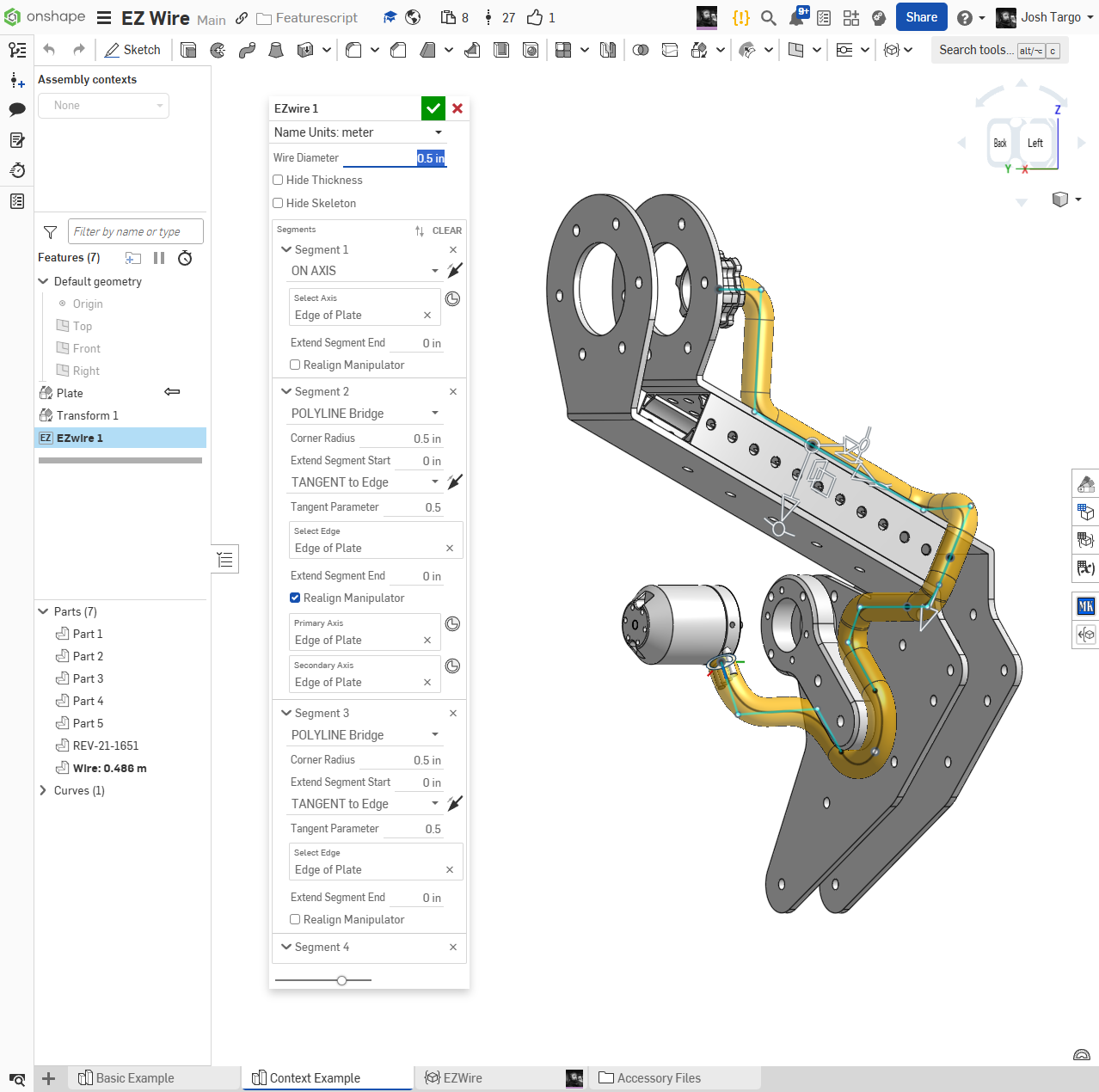

    @GregBrown, thank you. I rewrote that potion from scratch and now it does work. This is for my EZWire that I've been obsessing over for a few weeks now. Almost 1000 lines of code is big for me. Your "definition.whichPoint" is in there. A different approach from RoutingCurve.
