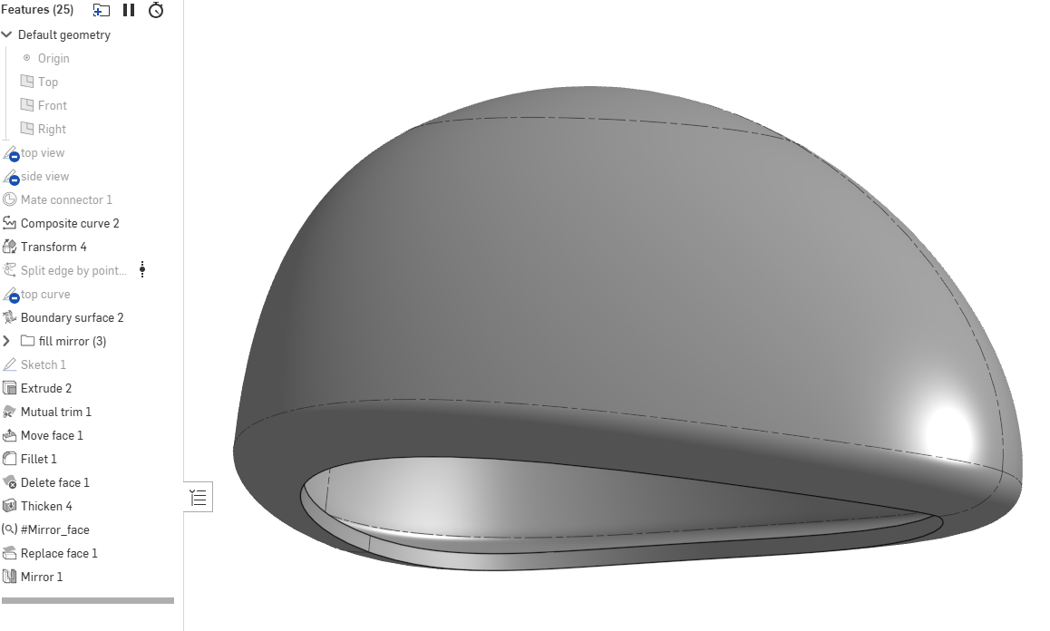

Apologies for the vague title as I'm struggling with how to ask this in a clear way. I've been working on incorporating more organic surfaces into my design and have been running into issues where an operation fails with no clear reason and I get the "boolean operation would result in a non manifold body" error. Here's an example below where I have a surface that I've tried converting into a body with thicken:
https://cad.onshape.com/documents/5d19429b3e484b308ed78715/w/af284b053108b6f5ddc0addc/e/1447284ddaf587b44d10846c?renderMode=0&tangentEdgeStyle=2&uiState=68bdc31907e26bf4684bffa6
I'm not looking for an answer to this specific issue (though that would be nice), rather where I can find resources on how to troubleshoot issues like the above.

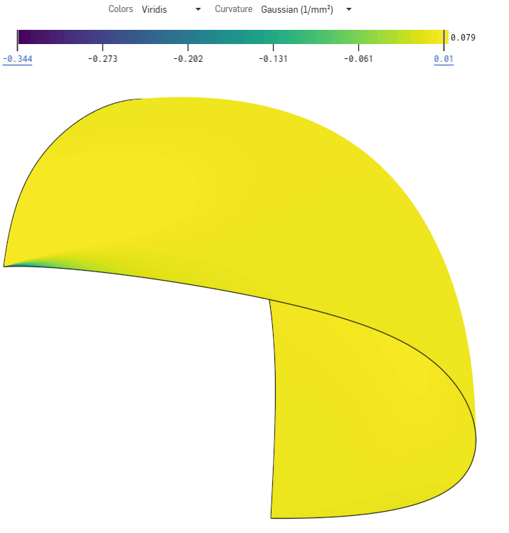

  • jelte_steur_infojelte_steur_info Member Posts: 673 PRO
    It happens if the parts are only just touching on an edge, but they don't have the same face.
    The parasolid kernel doesn't know how to deal with that. what's in/out…
    You seem to be working around the issue that you couldn't thicken the whole surface in one go.
    That's a tell that something more fundamental is off with the quality of you surfaces… So I'd rather focus on that than work around it.
    Probably caused by the loft ending up in a singular point which creates a lot of tension in the surface:
    You generally don't want all the isocurves of a face to end up in a point. They'd better run parralellish.
    @EvanReese explains well here why, somewhere around minute 25, but it may be worth watching the whole thing.
    not sure what the best strategy would be to create a 'helmet' with a proper 4 sided surface while working in a mirrored workflow…
    Anybody?
    another tip: Using a projected curve without approximating isn't recommended either because it's a less smooth input curve.
    also @GregBrown has a lot of videos on good surfacing technique that may be usefull for you

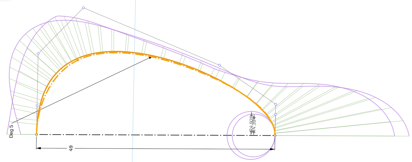

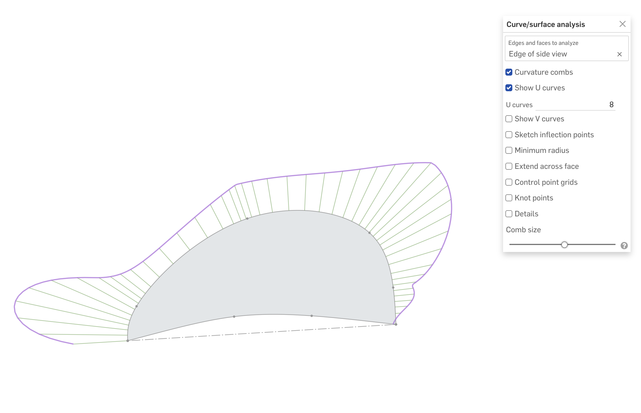

  • EvanReeseEvanReese Member, Mentor Posts: 2,967 PRO
    This is a great exercise to learn more surfacing stuff. You may not need to be 4-sided per se (but the Fill feature could probably do that here). In any case @jelte_steur814 is very right that the front area is where the problem is. I think the root issue probably goes all the way back to this first curve. I'd recreate it with a bezier to make it more smooth, or use the Edit Curve feature to reapproximate it with a cleaner curve.
    Secondly, the ends of this curve aren't tangent with the "up" direction, but the loft is set to that direction, so you're asking for something that's not physically possible. Consider making a helper surface to reference that is tangent to this curve at the right places then make the loft tangent to that surface.

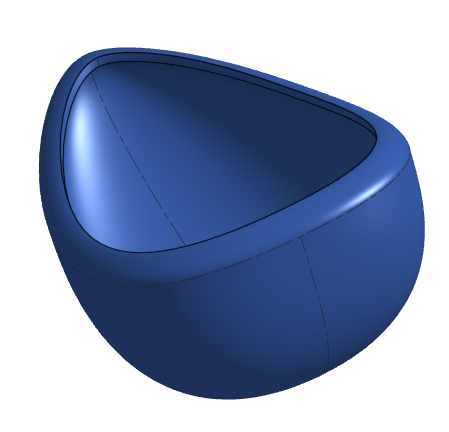

    I spent quite some time for my own practice and was able to create this: (using 4 sided surfaces)
    https://cad.onshape.com/documents/f2eb1b1707b03bdee4d7cebc/w/793e8ce1e6e4bc948fa21d5d/e/6212d149f63ae6e11266915c?renderMode=0&tangentEdgeStyle=1&uiState=68c00a111419e857efb1911b
    It takes quite some tweaking of the "top curve" with the final button on and zebra stripes to get the result to look good.
    I can't seem to get Curve 3 to be on par with the required accuracy for the 'boundary surface 4' to work without error/warning. if you skip that curve and let it do its thing it'll not look good at all either.
    An whole other approach is better there I think: see V5. can't get the width of the assymmetric fillet as wide as you might want it, but you get the gist of the simpler approach here:

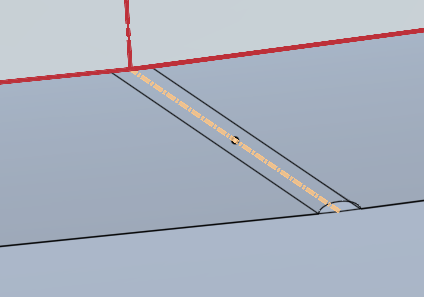

  • MDesignMDesign Member Posts: 1,429 PRO
    edited September 2025
    It's funny how one small missing constraint in the very first feature can spark such a deep discussion. The reason the boolean failed was because sketch 'side view' was missing a perpendicular constraint between the construction line and the one magnitude segment of the curve. This caused a crevice to be created on the first thicken operation. then mirroring it created like a half cone sorta type of divot. then when you went to boolean the next piece it did not like the 0 thickness at the top of the half cone.
    As far as a step by step how to troubleshoot that, I'm not sure how to explain that tbh. Kinda comes with experience and more issues that that you struggle with, it becomes sorta like common sense over time. Understanding what non-manifold meant was a huge help. That description of an issue certainly doesn't lend its hand to making it easy for newcomers to figure out what is wrong. Turning on translucency at times might help, locate an issue such as this.
    Here's a copy of your document with the perpendicular constraint added (minus a coincident constraint on the magnitude segment). and the boolean without error.
    https://cad.onshape.com/documents/b0032b4224ed53a65a8c4c19/w/2fdbbd9c1f6c2fa35848257c/e/96b1837cbc650bd824b7696a
