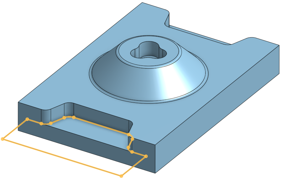

    In this example, I made a sketch and converted the sketch to a composite curve. This curve can be inserted into cam studio and used as a containment.

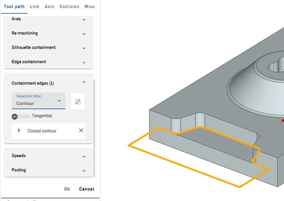

    Using the bodies + rough operation with offset, I enabled edge containment and selected the curve as the boundary.

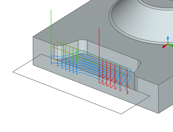

    Once calculated, the toolpath is constrained to the containment. In the future, we will have additional containment and stock recognition features that will provide more options for isolating toolpaths to specific regions. Today, users can use containment curves or silhouette containment to help control the placement of the toolpath.

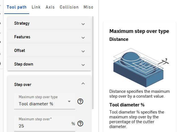

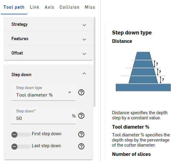

    Step down and step over can be controller by changing these settings in the toolpath.
