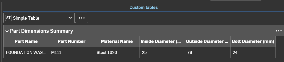

I wanted to know if it's possible to create a feature script that can read your configurations tables so instead of doing a csv, I could create one that automatically reads it and then I can create a custom table and insert that into my drawing.

    Not sure if it can be done in the current part studio, but if you use a PartStudioData input for a feature and select the part studio from another part studio, the PartStudioData input contains all the configuration data.

    What does your workflow look like? Is the configuration data to stay with the configured part? You could set up the configured part to store it's configurations data within a cutlist table, which could then be derived with the part and or inserted into drawings. If you aren't deriving it and your configured part stays within the its own part studio, then you could just use the standard table options and simply link the configurations to values in the table.
    You can write your own feature for this, or use one that already exists like the image.png Table custom feature.

    Well you helped me the last time by giving me suggestions (which I am very grateful for thank you) and I used your table.fs my collogue was not too keen on manually typing it out I took a copy of one of your other fs that you offered and customized it and I got this.
    so now it reads my variable which is good but now I want it to be able to read all my other variables that I have in my configurations. I wanted to know if that was possible or can I only achieve this via csv?

    It depends on if you are trying to read the configurations from your current configured part studio, or if you are importing / deriving that part into another studio so that you could get the PartStudioData like Caden mentioned.

    Here is an example of how to convert any configuration to a custom table or even a cut list table that can stay with a derived part. Either of these tables can be inserted into a drawing.
    For some reason tables are not behaving as they use to before some of the automatic Onshape updates and are not inserting or staying with derives properly. I've opened a support ticket for this, hopefully they will fix this soon.
    Configurations to custom table example
