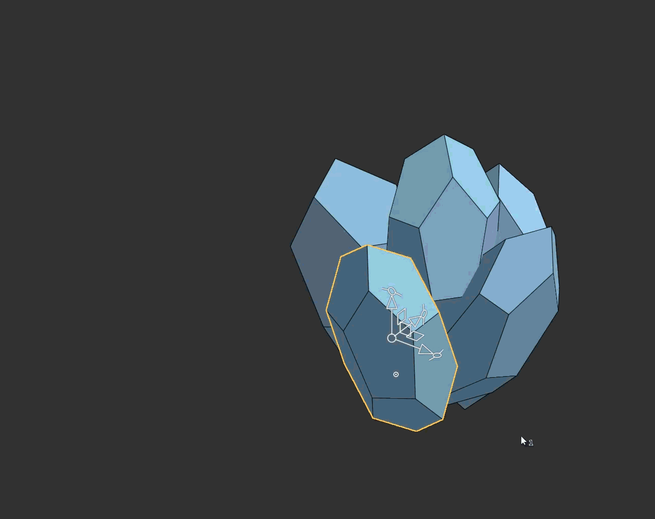

Onshape's vanilla transform feature doesn't give you those nice buttery smooth rotation handles to play with like the assembly tabs do, which is a shame because some of the most aesthetically pleasing structures aren't confined to the bounds of XYZ coordinates. I mean look at these crystal clusters moving around the screen as freeform as can be.
Wait was that a feature dialog window?
It sure was.
I've been working on some projects recently that necessarily need to be freed from the confines of coordinate grids and as much as I love the standard rotation transform and mate connector to mate connector transform they weren't letting the creative juices flow. So I made Triad Transform to bring that sweet full triad manipulator to the part studio environment. Use this tool to make your D&D minis look more organic and lively. Use this tool when your boss wants you to nudge that part over that way and rotate it 45 degrees just for looksies real quick, and he doesn't understand the difference between part studios and assemblies. Use this tool on your coworker's parts and hide it in their feature tree so that all of their drawing views are 0.5° out of alignment and watch them tear their hair out trying to figure out why their dimensional callouts aren't working. The possibilities are endless.

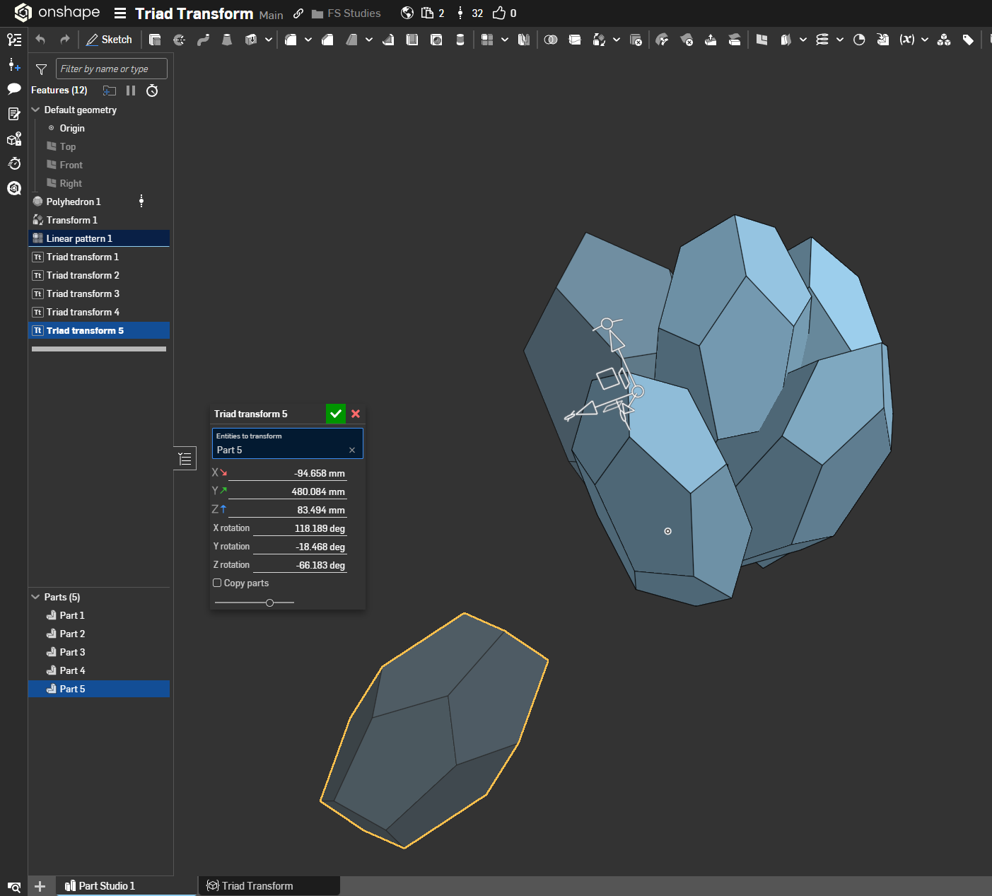

    Great tool. The interesting option that can be gained from manipulator usage is that you can add "snap to reference" behavior - in manipulator change function once any reference entities are specified pin the transformed origin of manipulator cSys to entities by recalculating evDistance from origin to those entities. Depending on entities type it would be possible to realign primary axis of cSys to tangent of edges or normal of faces. This would allow both non-exact artistic positioning but also the respect of underlying scenery

    @Konst_Sh excellent suggestion, I got surface snapping to work right away. Then I spent 4 hours wrestling with gimbal lock to try to get the rotational information to smoothly update as you drag the parts over a surface. I think I'll push an update with positional snapping first and have a good long think about how to best implement the relative rotational updates. My gut says quaternions are the way out but that's just a guess to be honest.

    I've wondered why you were decomposing transforms so granularily into matrices and rotation angles and tried to play with fullTriadManipulator myself. At first the task seemed as simple as applying the transform from manipulator to base coord system in manipulator change and store the new coord system in hidden field of definition, but whatever I was trying the resulting cSys was rotating right in the opposite direction of what I was rotating my manipulator. I've already decided that I'm simply too dumb to comprehend this, but as a last resort I've tried to invert the linear component of transform provided by manipulator change function and all of sudden it started to work as intended. So this actually looks like a bug in provided transform info for this type of manipulator
    https://cad.onshape.com/documents/000ce90a092a3a48c089b2a1/w/3268e695e55442ca72aea3a3/e/72b9500b043c19b2efdf4e1c
  • Derek_Van_Allen_BD
    That's more or less the route that development took for me. I started with the simple answer and it didn't work, so I brute forced an inelegant version that does. I'm still not sure if this rotational behavior actually is a bug or I'm just reading stuff backwards, and I'm leaning towards me reading it backwards.
  • Konst_Sh
    But the translation component is set in expected direction, while the rotational matrix is reversed. it just doesn't make sense to me
    I'm looking at Routing Curve to try to intuit some answers, since it's the only place that the full triad is used in the standard library. It apparently uses some matrix transposition for the rotational component for bookkeeping purposes in the feature? But I still can't understand why either.
    Positional snapping added. Still wrapping my brain around rotational snapping.
  • Konst_Sh
    You can find example with snapped rotation option in my document, just don't set base location mate connector, or its starting to freak out. This full triad manipulator feel too inconsistent for now though, it shouldn't be that complicated to do as simple things as positiining one csys relatively to another
    Oh yeah I see how it behaves with the mate connector set. That's really nauseating how it disconnects and floats away. I'll probably leave it alone for a minute because in order of priority positional snap is way more important than rotational anyway.
