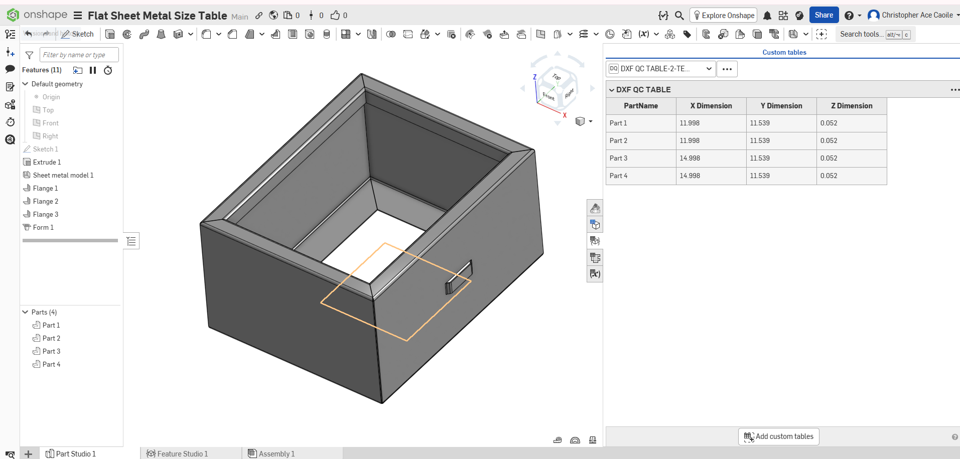

    Hi Siddik,
    I use this to get the flat dimensions of my sheet metal designs. Just load the featurescript as a custom table… Maybe you can use this
  • eca_elioaceca_elioac Member Posts: 18 ✭✭
    a sorry… I thought you just need to know the x,y, and z values of the flat part… If you need to set those values as property you will still need to mod my script using "edit logic" so that you can set the extracted x,y,z dimensions as property of the part
