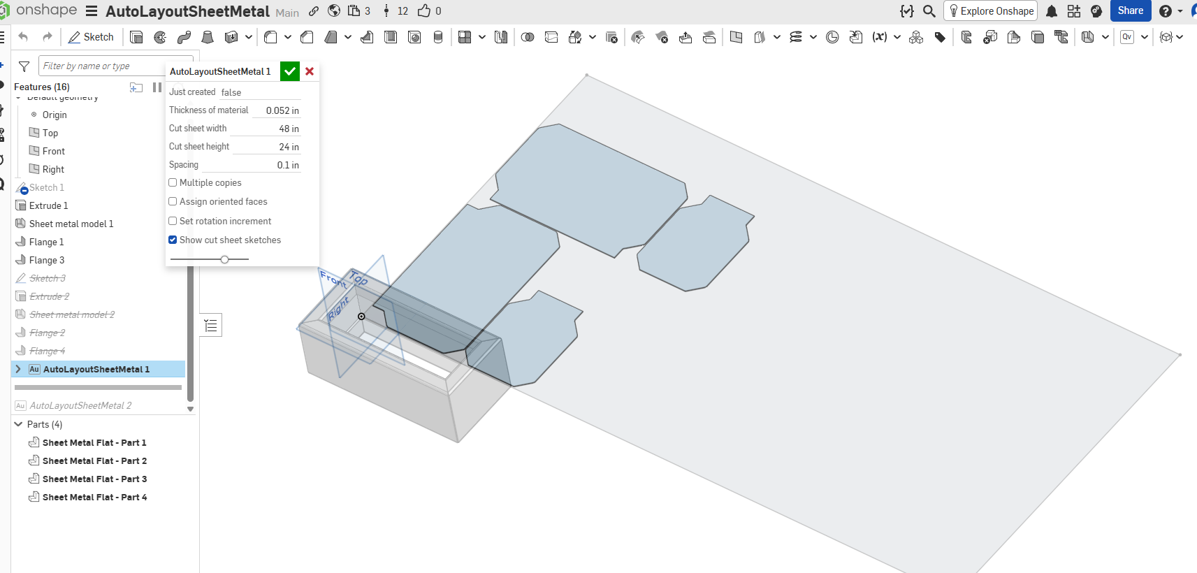

The first thing that jumps out at me is that you have helper functions defined inside of other functions, which featurescript doesn't do. That's a feature of other programming languages that isn't present in Onshape and is one of many pitfalls of featurescript to navigate when you're first getting into featurescript. (Or the first thing you need to beat out of your LLM when vibe coding featurescript)
1 -
https://cad.onshape.com/documents/05ec5731d9652cd18e67b419/w/e09df67226274bc109b74013/e/ff2cf70d79e4dcf26f2288b1
I realizerealized afterwards that I did not include my code… here is a link to the file I'm working on. And my code is below if that doesn't work:

https://cad.onshape.com/documents/69d8fdcfa3b7a1eeabf7337f/w/f34ce052f3dfc2c1efd0309b/e/96d738e69f4d10e314786d4a
the above FS is based on Arul Suresh's Auto Layout Feautrescript (Edited to work with sheet metal)The solver is not too accurate though so you might want to edit the actual algorithm portion of the script.
