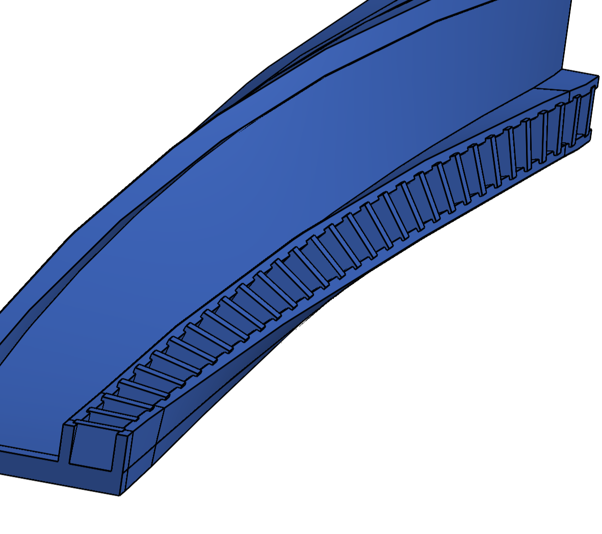

hey all! another janky feature from the smidchens household - take whatever path you want (elliptical, polygonal, spline…) and generate gear teeth along that path using local curvature to drive involute profile.
snag it here: https://cad.onshape.com/documents/8f033780ed64a1971e38c2a9/

  • S1monS1mon Member Posts: 4,235 PRO
    What wizardry is this?
    I kinda get the pitch circle and the other pitch ribbon, but the other wavy one…. can you explain the man behind the curtain here?
  • imants_smidchensimants_smidchens Member Posts: 80 EDU
    Ok it's a bit jank, but the principle is as such:
    it's not hard to set up the path for the pinion (tangency between pitch curves, coplanar), the hard part is getting the rotation to match the motion along the path.
    My thought process was:
    * I am converting from translational motion to rotation, so I will need something like a rack and pinion relationship
    * The ratio changes as the pinion moves along the path. This ratio can be expressed by the accumulated rolling distance along the path
    * I wrote a quick script to convert between the x position on the pitch path (assuming it is monotonic in x) and the accumulated rolling distance, fitting a spline to this. That's all that second ribbon is: a geometric representation of the function mapping from x coordinate to rolling distance as a y coordinate
    * there's some helper geometry to essentially just capture the relevant stuff from there:
    * a line pointing from center of circle to the tangent path, with a tracker on that intersection (the contact point between the rack and pinion)
    * a thingy that matches the x position of the tracker and travels along the x axis (probably redundant but ehh)
    * a thingy that matches the x position of that, tangent to the function curve
    * a thingy that matches the y position of that, locked to the y axis with a slider relation
    * a rack and pinion relationship between this y axis thingy and the rotation of the pinion
