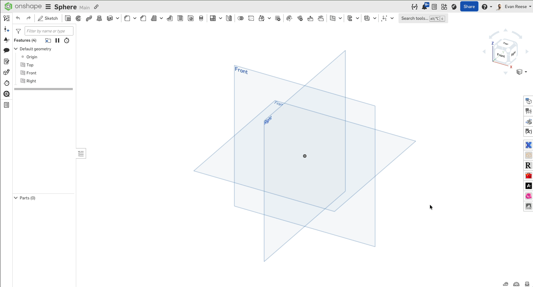

How Do You Make A Sphere??????????????????????????????????????????????????????????????????

Draw a half circle and revolve it 360 deg. That's the way.
Draw a circle. Draw a line through the middle of the circle from top to bottom. Finish the sketch. Start the revolve feature. Click on half of the circle as the profile, and select the line as the axis. Voila! You have a sphere.

but for real I made a custom feature for this a while back. You can get it here. Others have already covered the more traditional approach with revolve.

Was gonna say, I just use the Sphere feature to sphere.
