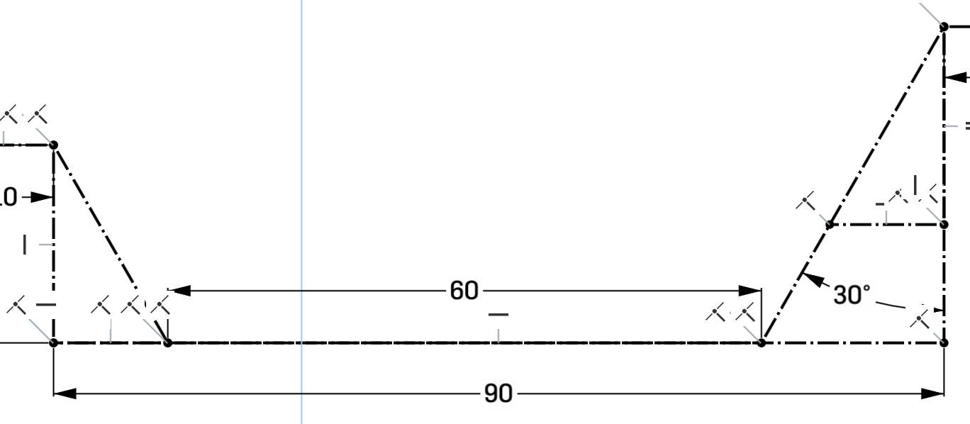

Draw two centerpoint arcs where you would expect the angular dimension callouts to be. Set them as 'construction', then set their radii equal to each other. Draw construction lines between the endpoints of each of these arcs, then set their length equal to each other. you now have two equal-radius arcs with equal distances between their endpoints, thus their angles will be equal.1 -
If you have right angled triangles then you only need to create a perpendicular segment that's connects to the hypotenuse and is the same distance from the point of the angle you're trying to make equal on both triangles. In this example the triangle on the left has the shorter of two opposite edges so the measurement is from the angle (the top point of the triangle) to the right angle. On the right-hand triangle you see an additional construction line that is the same distance down from the top angle's point. You make those lines (in this case I needed to draw a second construction line from the angle to the vertex of the perpendicular line) euqal with one another and then you make the length of those perpendicular lines an equal constraint as well. This forces the angles to be the same.
