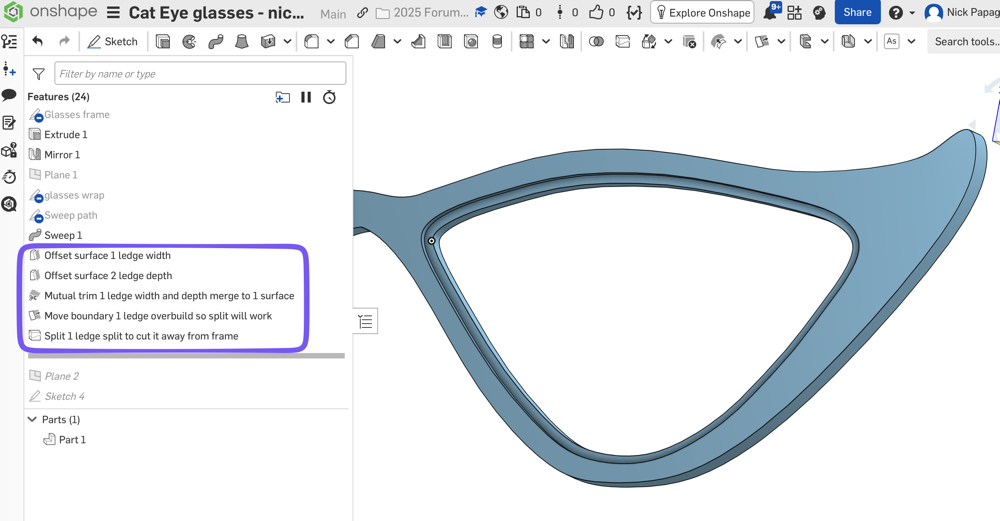

Re: trying to make a ledge to drop lenses into on curved glasses
The glasses look great for a new user!
Here is another approach using surfaces. A 3d shape like this is often simpler with surface offsets.
https://cad.onshape.com/documents/ab88d06e11a1a034078630d4/v/86bff94333908aa02c645ab8/e/4d3226456457ac206bd7a636?showReturnToWorkspaceLink=true
If you model half the glasses and then mirror at the end, it will save you a lot of work. You have the mirror at the beginning now, and are doing double work for each feature, such as the lens ledge, the hinges, etc.
You can keep the mirror so you have a sense of what the full glasses look like, then keep rolling back before the mirror to add new features.
The surfacing technique would also be helpful when you get around to making the lens. I'd probably make the lens much earlier, and use it to make the lip too. When you swept the shape of the frame, if that sweep was a single surface instead of a double sketch cut, it could be the lens surface too. Then you can offset/thicken that root surface separately; Once for the frame (thicker), then again for the lens (thinner)..
One more since you're new to OS, you can model everything together in the same part studio. The frame, the lens, the temple, etc. (and mirror all at the end).
I made a 1mm offset of your sketch, then used that to do an extruded cut up to the face of the frame plus 1mm (offset distance) - https://cad.onshape.com/documents/71ef81a86b19f394a6c561d2/w/7a47520f0ffc03db1e02f22f/e/eaa1963e63d0cdf71fcd7434?renderMode=0&uiState=696e315b465b25b4aa492002
