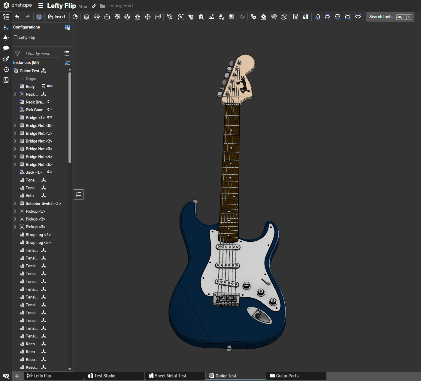

New Feature: Lefty Flip
After seeing loads of forum posts about the want for an assembly mirror, and lots of my team's gripes about wanting non-assembly mirrors that flip the original input parts instead of creating new ones to maintain the flow of downstream operations I decided to do something about it. This is not an assembly mirror feature. This is just a tribute.
I present to you Lefty Flip, which allows you to create left handed configurations of your parts while fully maintaining original part IDs, edge IDs, face IDs, pretty much everything I threw at it in one afternoon's worth of noodling. This means any mates you define at the assembly level for your right hand configurations of parts will also be defined for the left hand configuration when you change between them. Assuming you mated things any kind of reasonable.
To demonstrate I found a copy of a Fender Stratocaster assembly someone modeled and published on the public docs, but left out all the lefties.
And then applied the script to 3 part studios for the parts that would be flipped on a lefty guitar and none of the ones that wouldn't
Lefty Flipped.
Normally creating a left handed configuration of a product would require forethought and intent and good assembly structure and you'll still end up with a folder of suppressed mates at the end that you'll look back on later confused at how things are meant to relate to one another. Heaven help you if it isn't your model. Now you just need one feature and a configuration checkbox.
Just select the bodies you want to mirror in the part studio and optionally define a mate connector to center your flipping operation on. If nothing is selected it will use the part studio's origin as the center. It does do a left to right flip and not a front to back or top to bottom. Our company operates under Earth gravity but let me know if you work on parts for space and want the option for front to back or top to bottom flips and I might update this to add those at some point.
And because my team wouldn't live without it, it does sheet metal too. But only if you flip everything in the context at once because things were getting unstable when I tried to do only single pieces out of context. Probably that's your intent with a left handed sheet metal model in most cases anyway.
