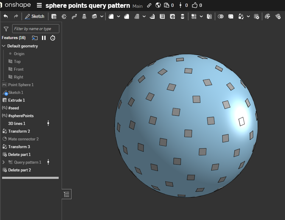

Query Variables and QV+ have completely changed the way I approach development because it's much easier to build concepts of a script in a bunch of part studios before ever writing a single line of code. Somewhere in my pile of demo studios there's a version of Tweep that started as me mashing together existing scripts and basic features with queries passed between them to see if the theory of the feature would work.

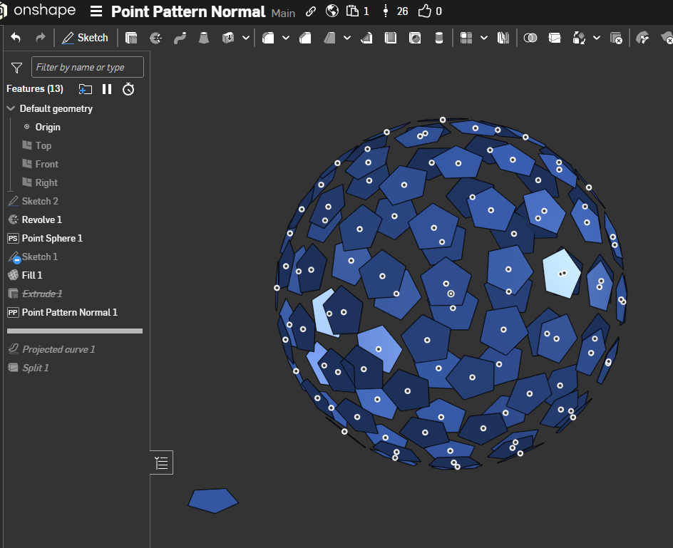

Here's some early access to the Twurface sandbox. (I probably will not call it that) Lots of demo cases that don't work at the moment because B spline surfaces are a beast of calculus and I'm a college dropout who failed math 3 times, but also lots of demo cases that DO work and that's promising.
