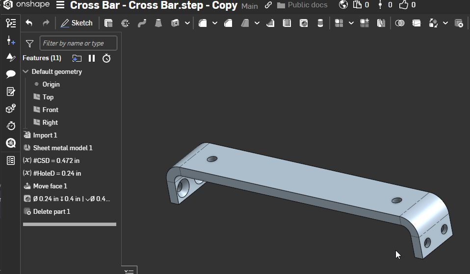

Re: New Dude Having Problems with Copying Parts
Noticed you are using the free plan so had a look…
Here's how you can create the Lead sheet part in 40s by using the same part studio as your main chassis:
I would also recommend using the "hole wizard" tool for screw clearance holes etc…
