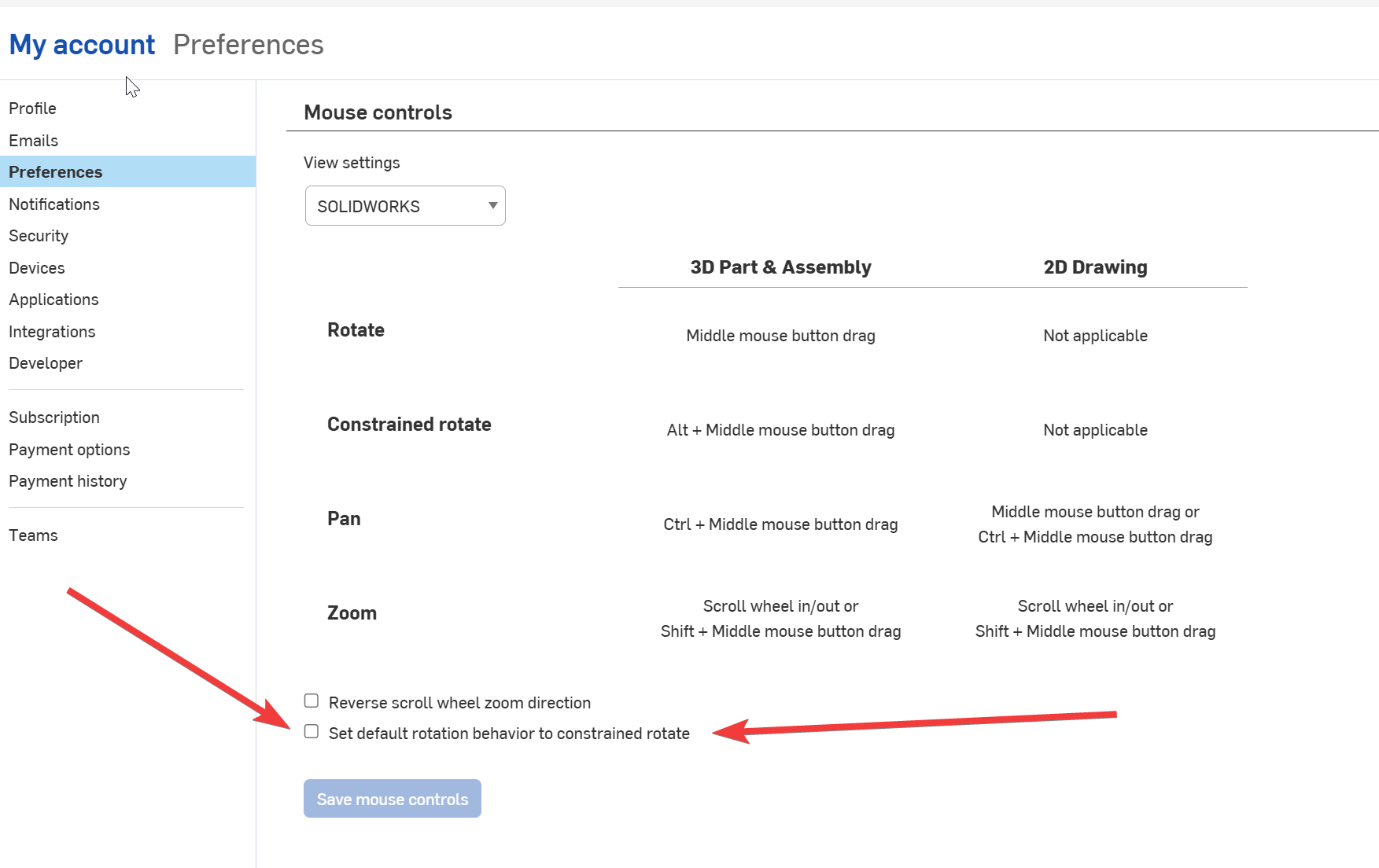

We making furniture and room layouts. We are 100% in constrained orbit.
Would Onshape ever add a feature to enable a constrained orbit - rotate about scene floor instead of Alt + mouse click?

It's been a long time since I've checked on this but the software is updated.
You can now do it.
See screenshot for preferences.
There's an improvement request for this. https://forum.onshape.com/discussion/5241/set-turntable-z-axis-lock-as-default
This is definitely a polarizing thing that will need to be optional for different people. I'd be fine that way, but there would be a lot of angry people if this got changed to be a constrained orbit all the time.Simon Gatrall | Product Development, Engineering, Design, Onshape | Ex- IDEO, PCH, Unagi, Carbon | LinkedIn
