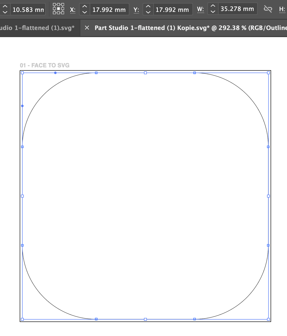

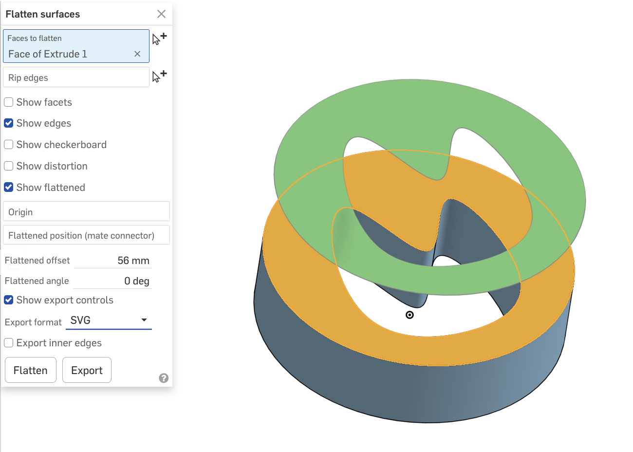

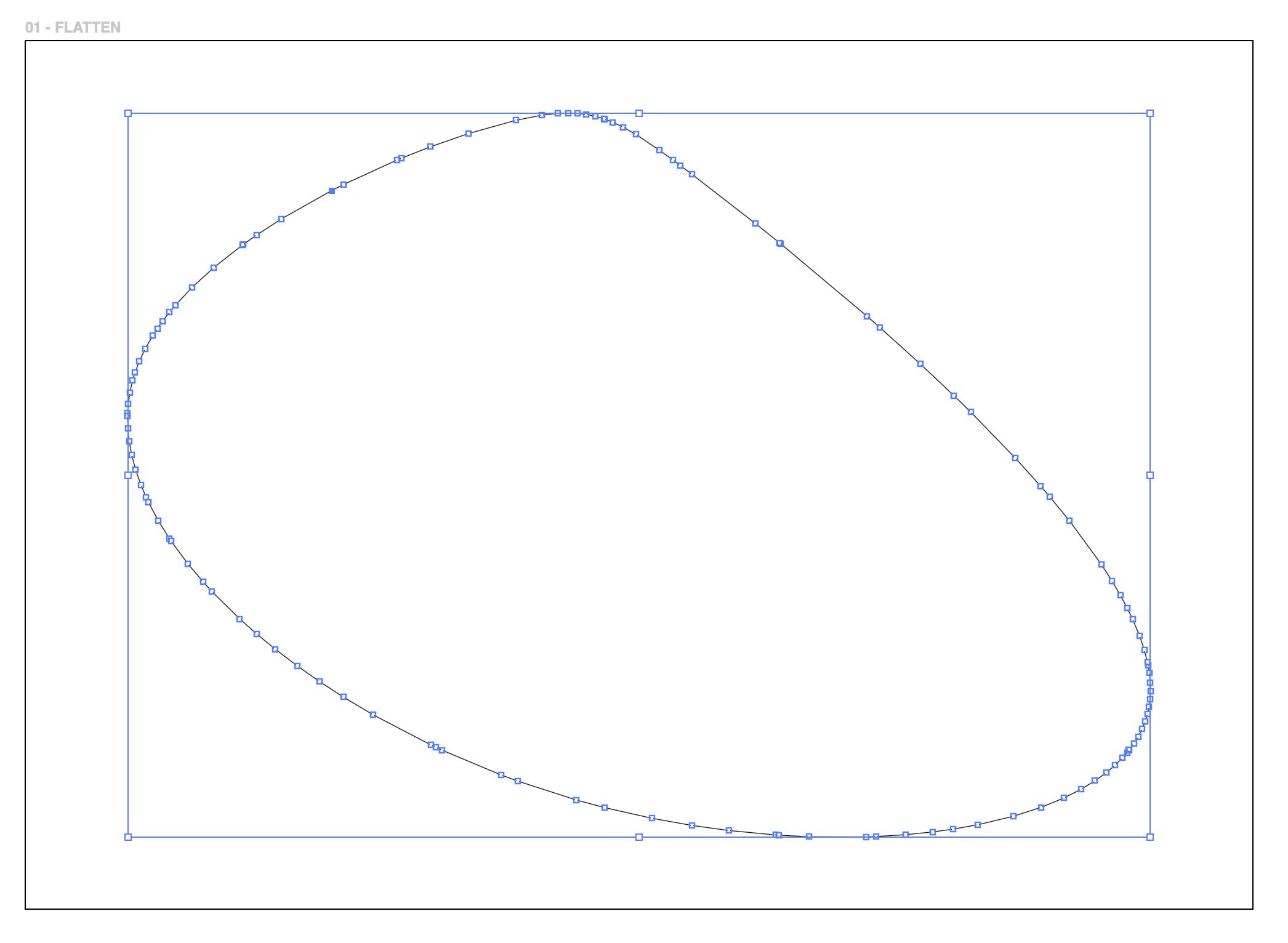

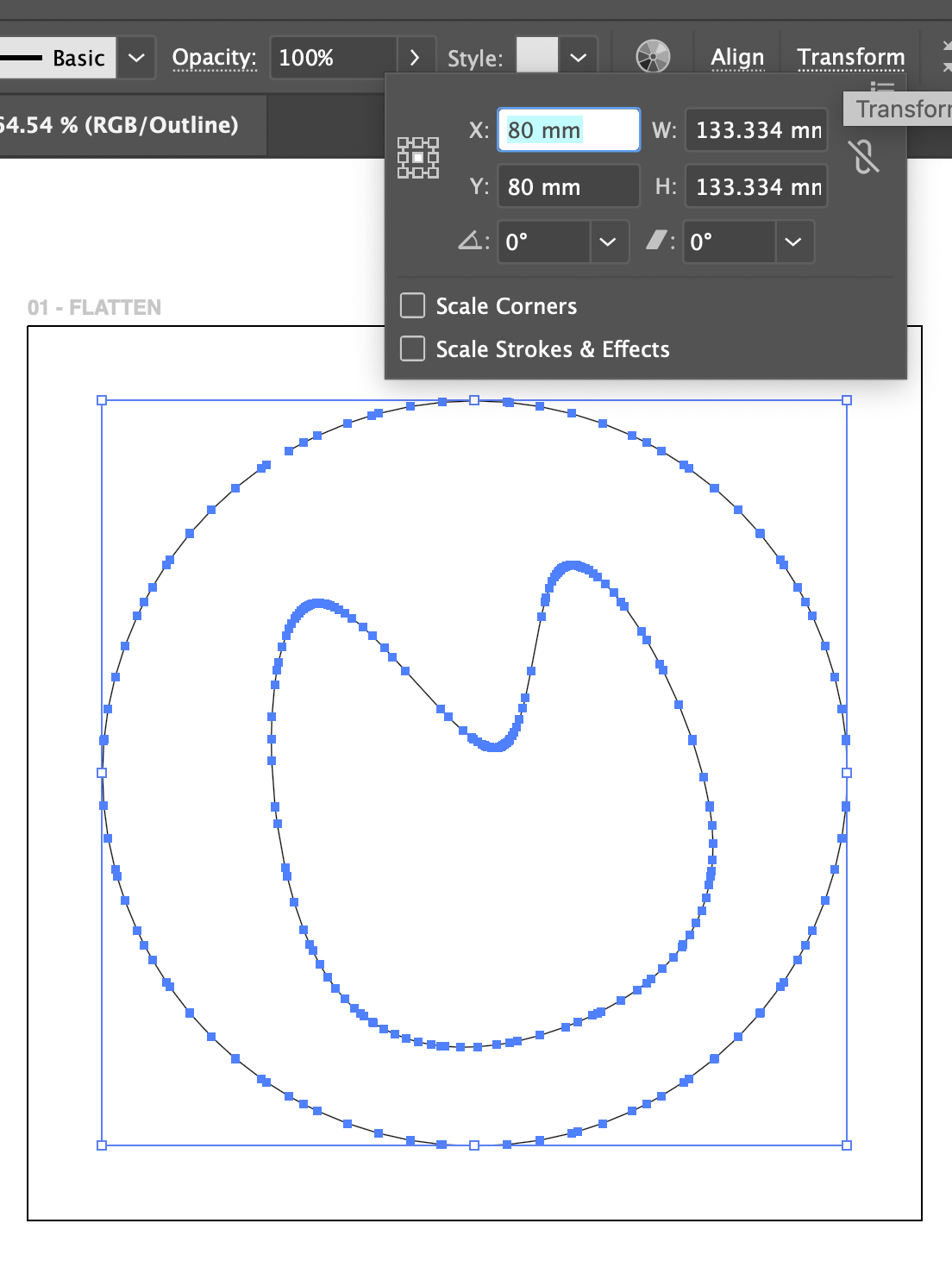

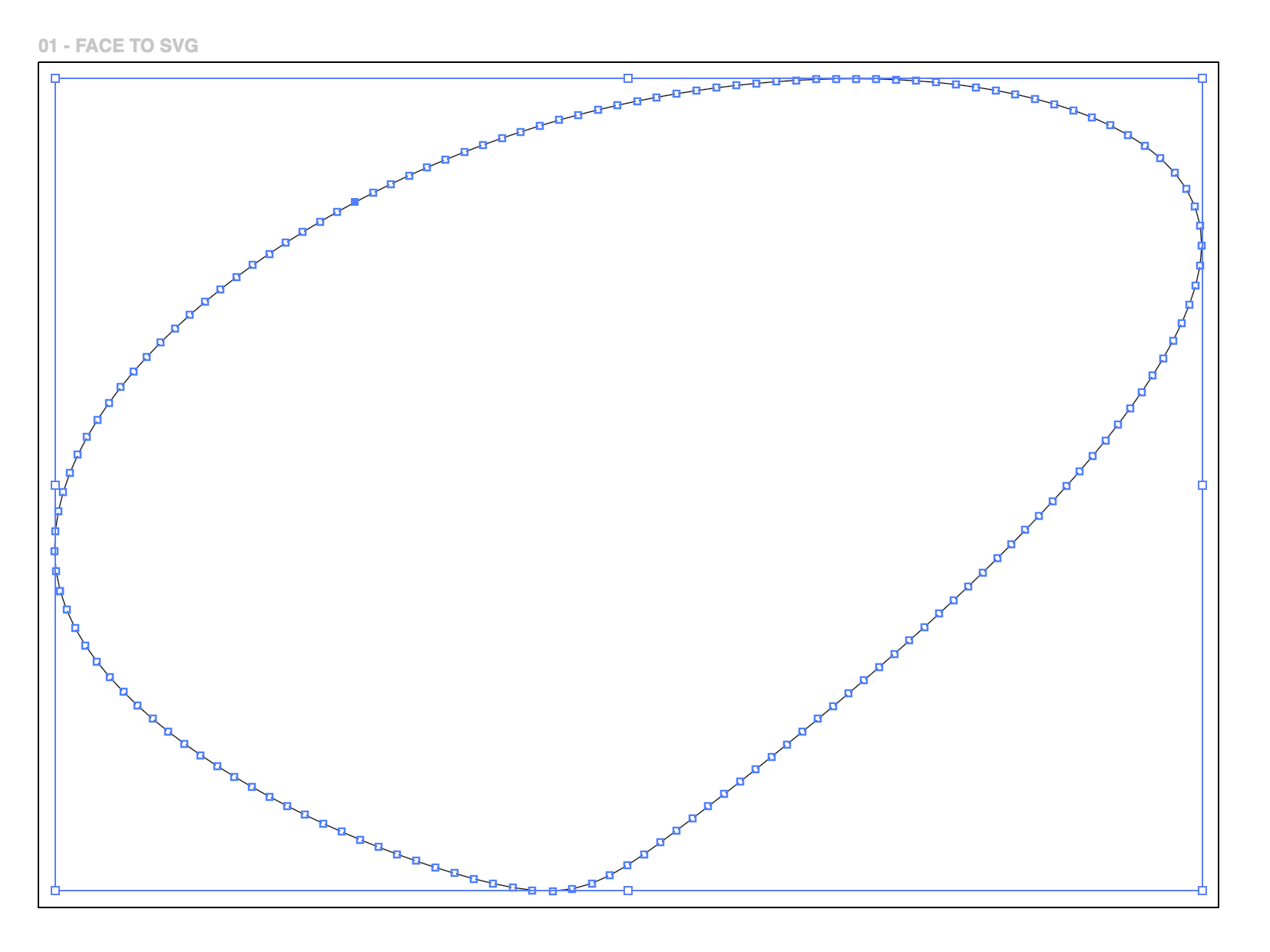

    Ok! I did a bit of research with the FacetoSVG FS and the export function on the “Flatten Surface” tool… a circle part with a curvy hole inside using Illustrator to check size and lines of the SVG.
    Both methods converted them to polylines and the size is off. The circle should be 100 mm.
    • The FacetoSVG FS is too small (83.334 mm).
    • The Flatten SVG Export is too big (133.334 mm).
    • The FS has no inside shape
    • the Flatten SVG is open on the outside (it does close when there is no hole).
    Looking at just the curves:
    • The polyline segments from FS are evenly distributed.
    • The Flatten lines are not.
    Lines and Circles
    • shapes with no curves but only lines and circles look awesome with the FacetoSVG FS (but still the wrong size)
    Conclusion:
    • For Freeform Shapes, The Flatten tool is probably easier to use since it’s built-in and exports an SVG right away, but it also can’t handle multiple faces (though going through them separately is fairly quick).
    • For geometric parts with fillets and straight lines, the FacetoSVG FS method is better than anything we get from other export options (Drawing to SVG/PDF → a million polylines; Face to DXF → not closed) but the sizing is wrong.
    • For multi-part, multi-face jobs, creating a drawing and then manually joining the lines in Illustrator is still the best option (because the size is correct).
    thank you @hovis and keep up the good work!
