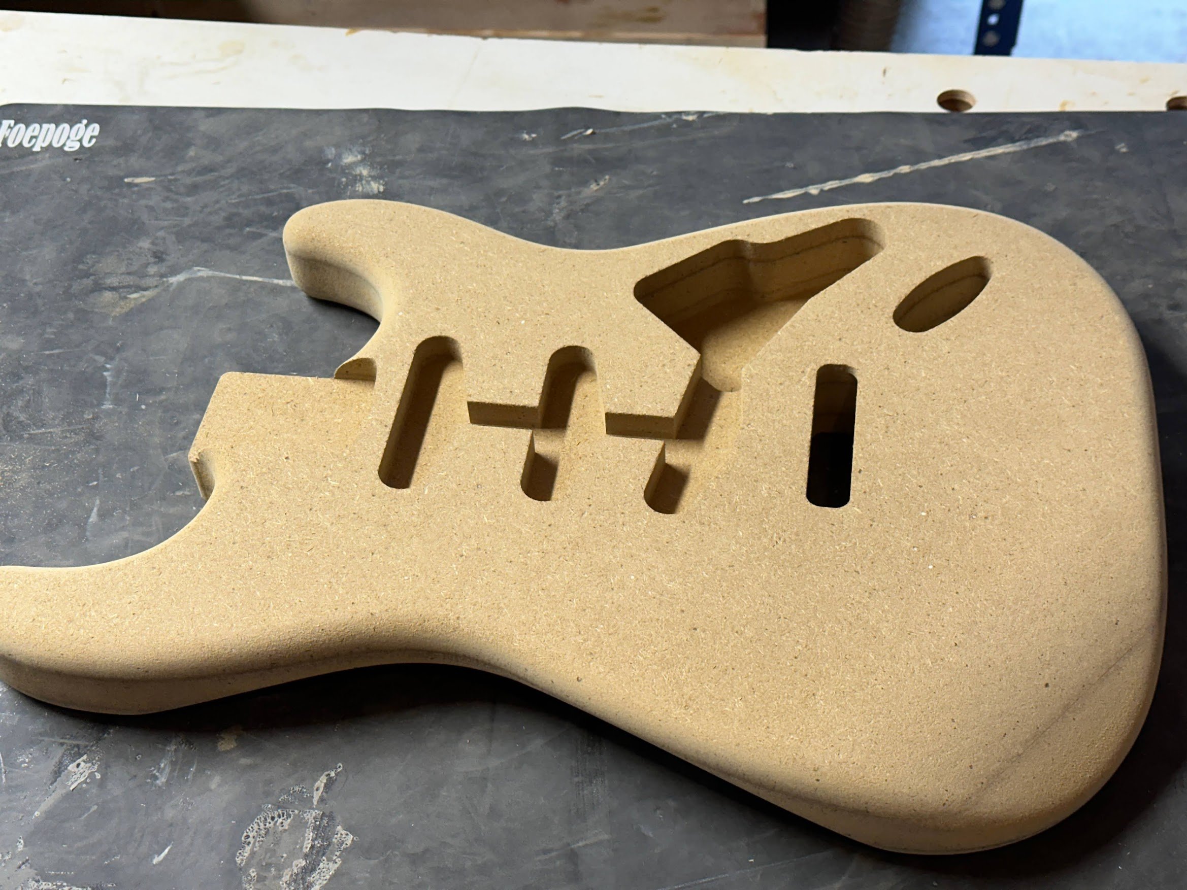

  • joe_dunnejoe_dunne Onshape Employees, Developers, csevp Posts: 198 image
    @kevin_white
    Hey Kevin, glad to see you have signed up for CAM Studio.  I have cut a few guitar bodies already.  This is just a test cut out of MDF....

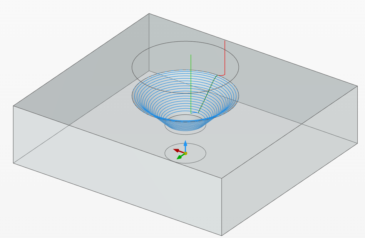

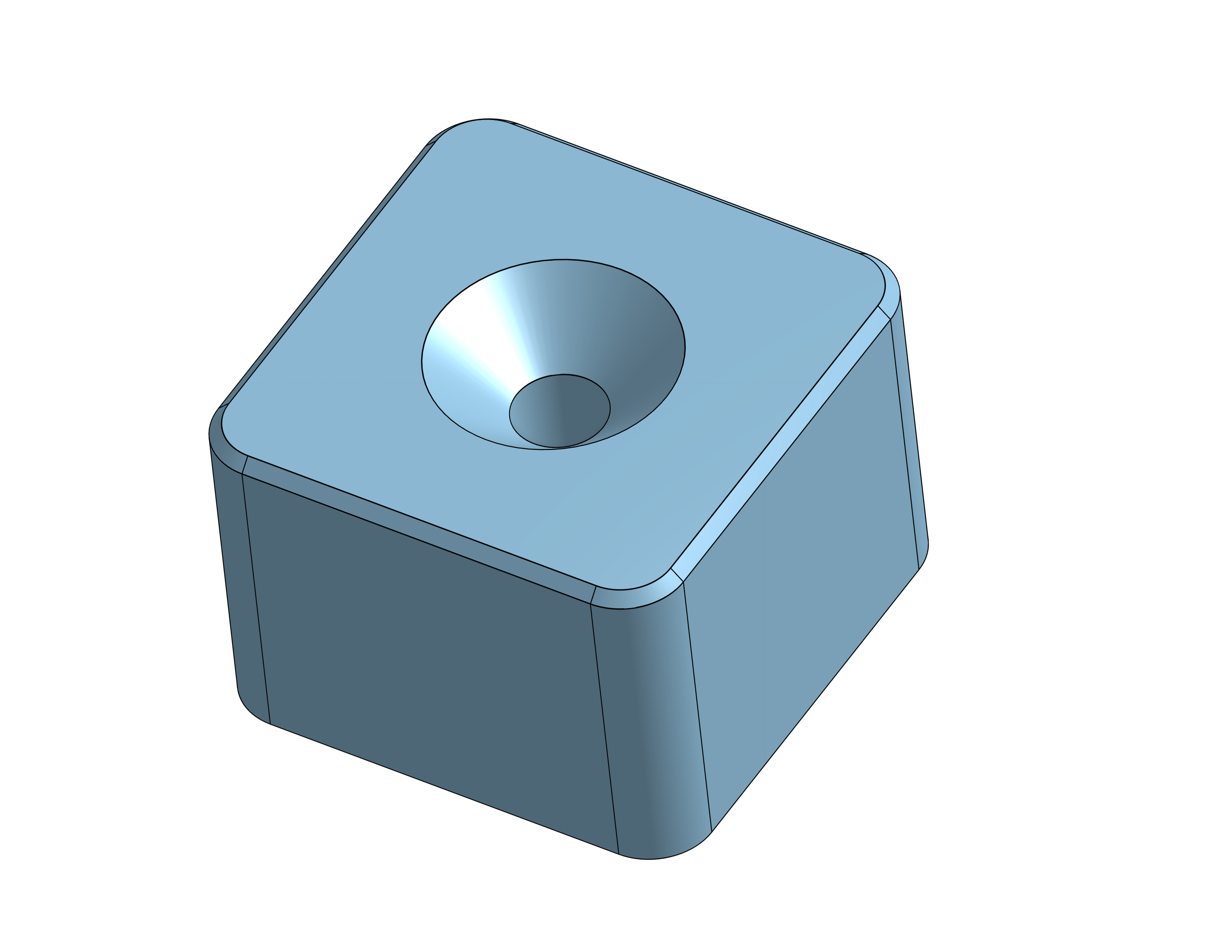

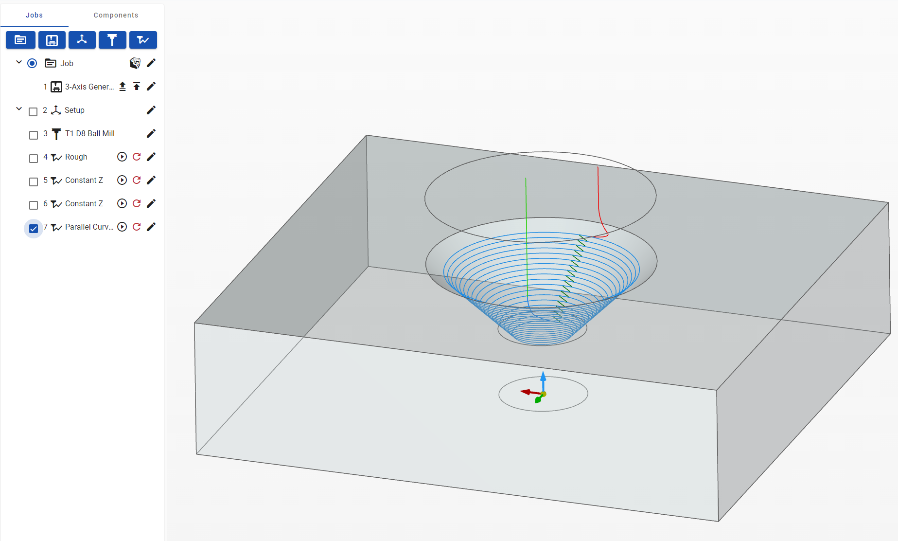

    Not truly digesting the machining terminology, I am sure I am missing something. However, I have been using a Constant Z movement to do a profile countersink feature. I would like to have a Helical Z move and use a Cusp height setting for of each step in the Z direction. If it is there in a machining setting, I can not find it.  Also, I would like to have the ability to have a containment sketch to be able to machine a specific features. It might be my approach, but it seems to give me All or Nothing.  My Test model is a square block with chamfered edges, a Hole in the center, and a counter sink feature at the hole center. To do this has taken me numerous machining settings before I get it right. I realized there is no manual or video to reference the commands, so I understand our learning curve. And I am not trying to compare this to our current CAM software (EdgeCAM), that has evolved over years, not months.  In another point, a total machining timer would be nice.
  • John_P_DesiletsJohn_P_Desilets Onshape Employees, csevp Posts: 267 image
    @spiritrider Can you post an image of the feature you are trying to machine? I am sure we can come up with a few different approaches. Thanks!

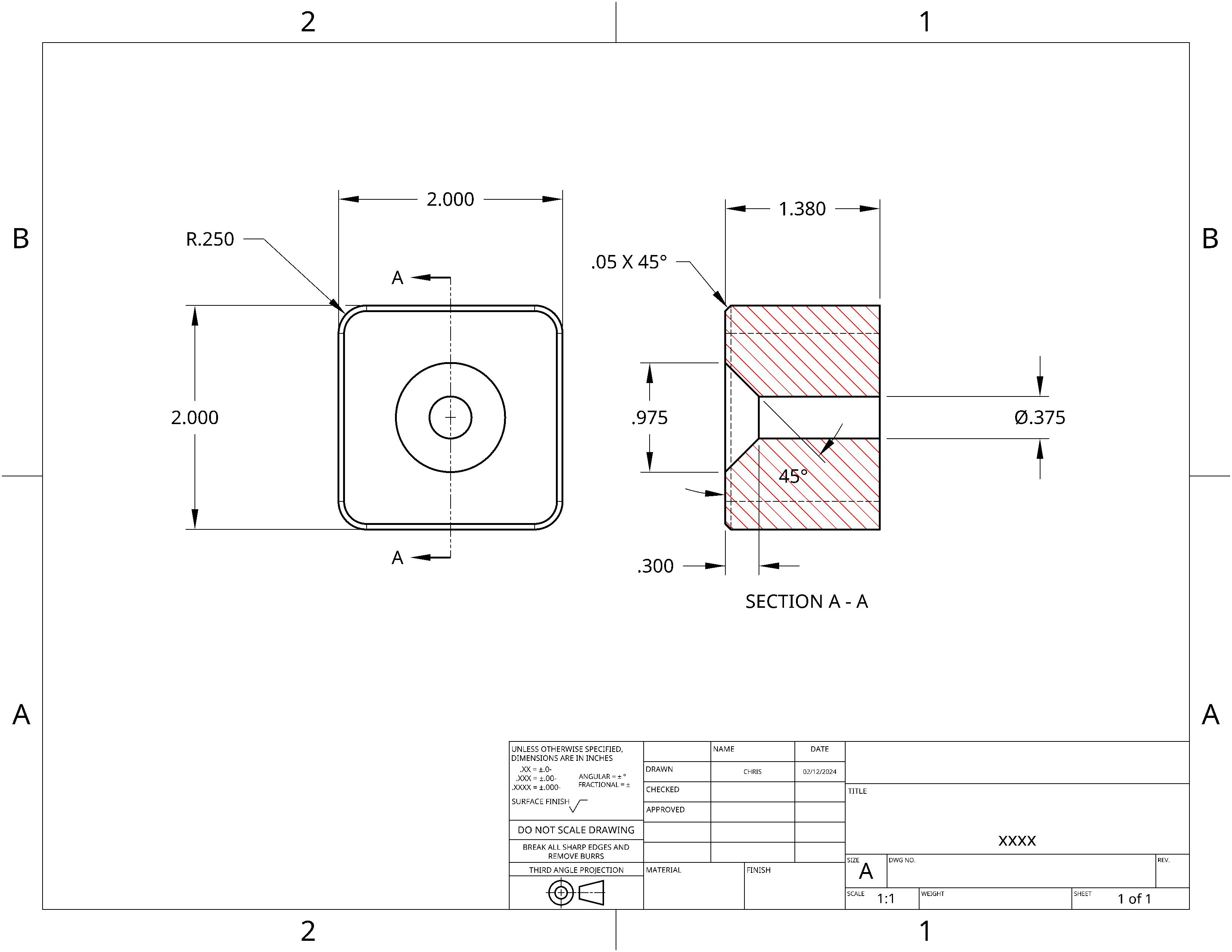

  • spiritriderspiritrider Member, csevp Posts: 32 PRO
    John, Here is the view and print of a very basic part. I do have a post for this but not pleased with the ability to do what I stated above. I can share the doc with you if you like.
    edited February 2024

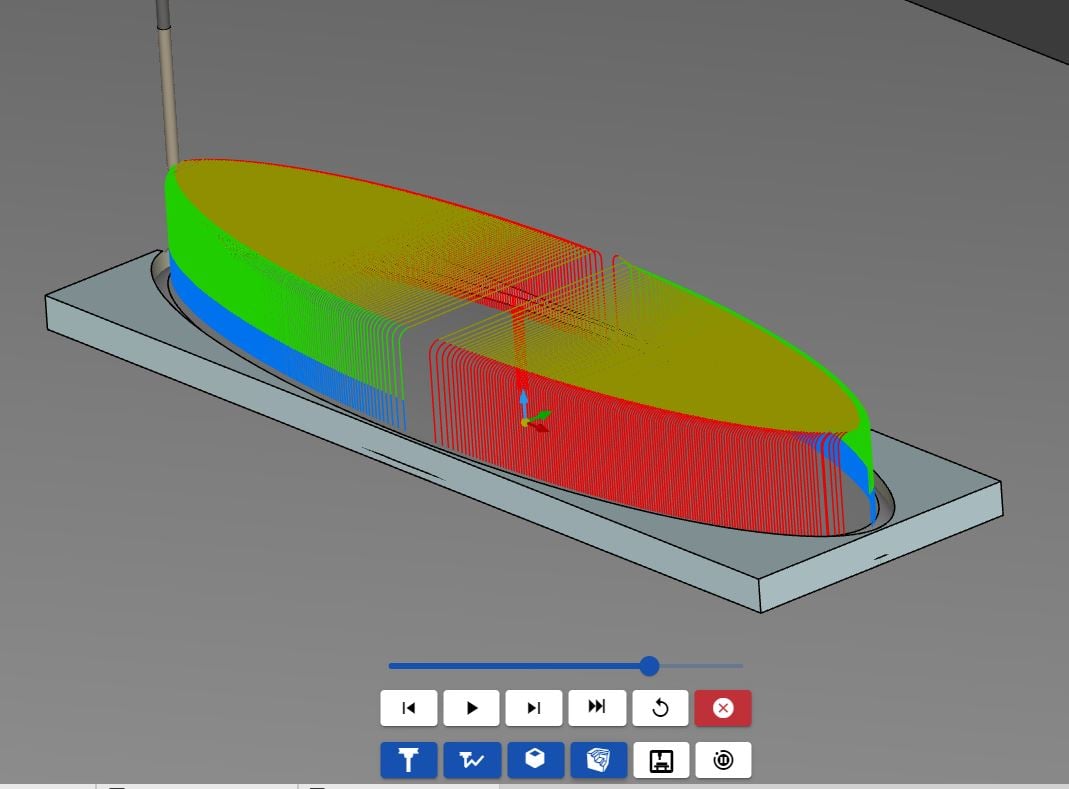

    @spiritrider  I made a few examples. We can review together on a call if you would like.

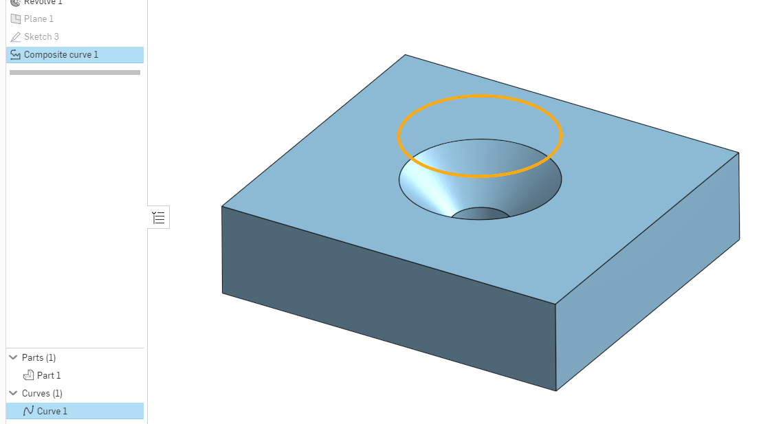

    For containments. Today, users need to create a composite curve of your sketch and insert the curve into cam studio. You can also use the edge of the part as containment as well.

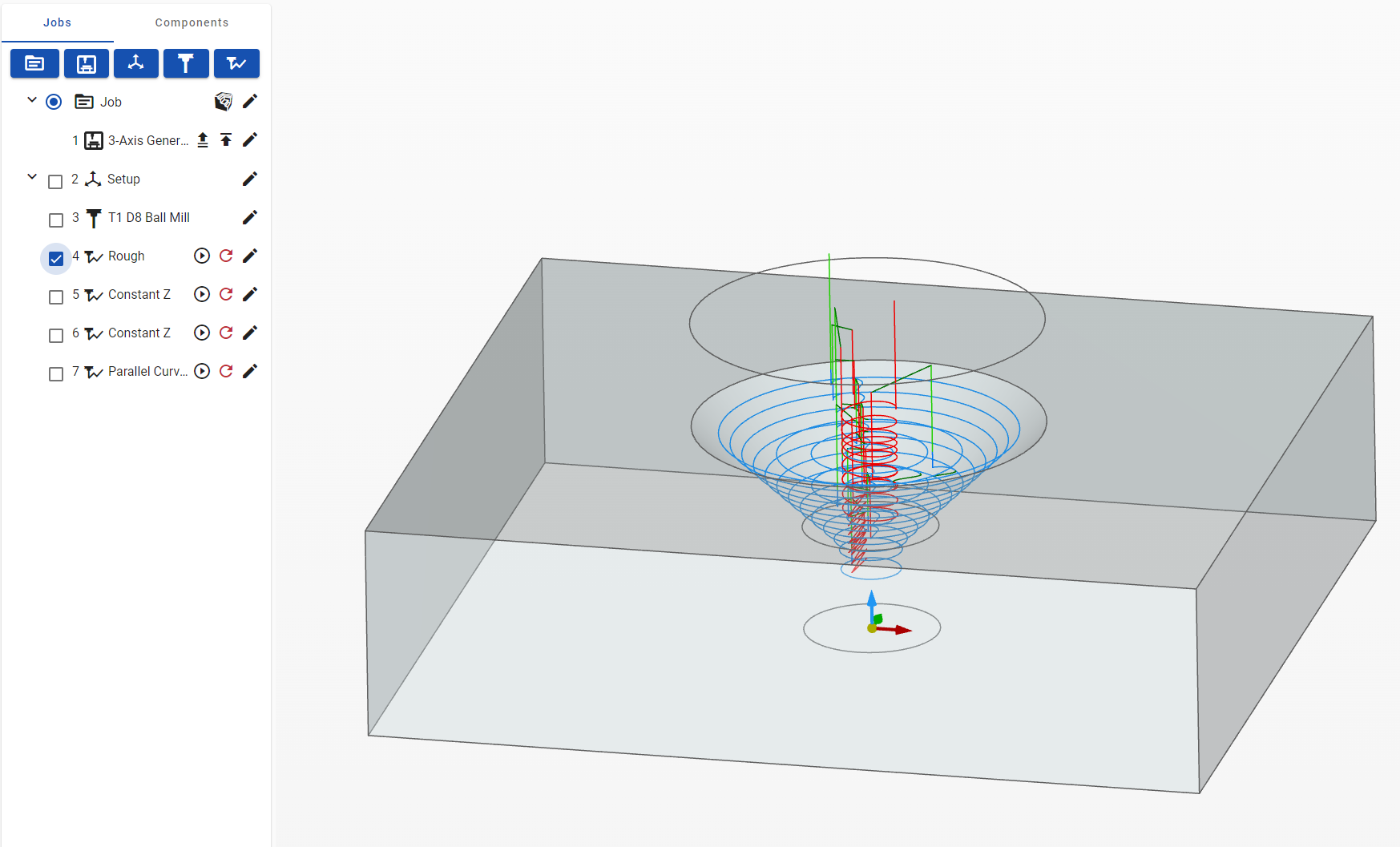

    I made a few toolpaths using a ball endmill.
    Roughing.

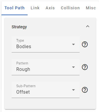

    Bodies, rough, sub-pattern offset. (when using a ball endmill for roughing, you need to disable "remove corner pegs" in the misc tab under smoothing)

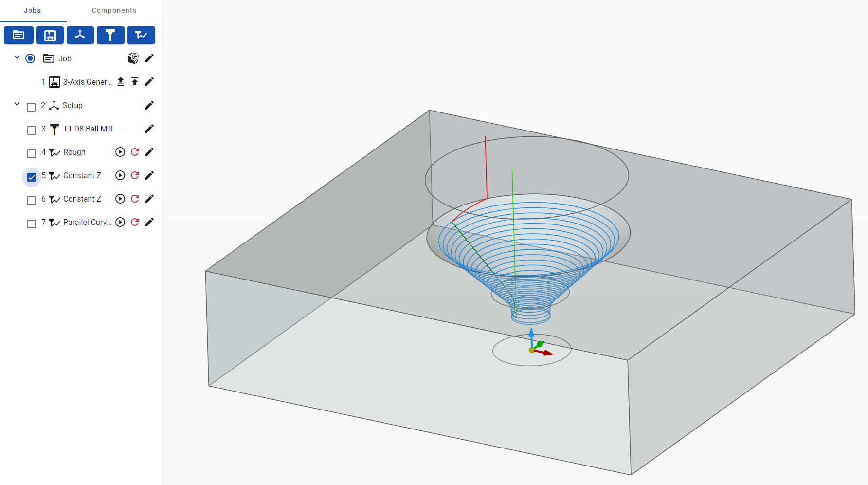

    This is a constant z with a step down of 10%. I need to check if constant cusp step over is supported or not. I think today we can only do distance, tool diameter % or number of steps for constant Z.

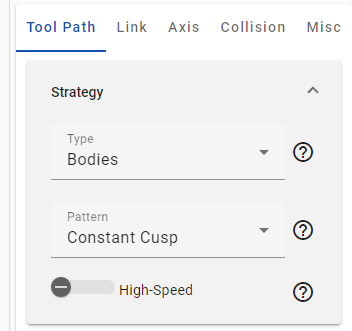

    The last is parallel to curves / edges. This allowed me to set a constant cusp step over amount. Similar to constant Z with more options. Additionally, in the misc section, there is an option for "extend/trim" that allows you to extend or trim the drive surface. I added 10% tool diameter to the start and end of the drive surface to clean up the edges.

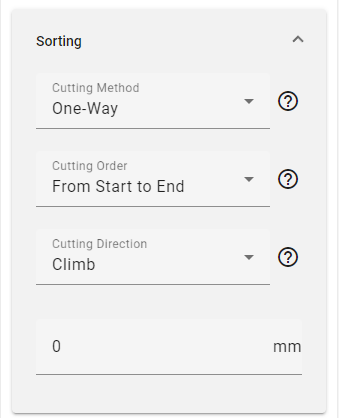

    This is the const cusp toolpath. The sorting has been changed from standard to "From start to end". The step over is set to 1mm cusp height.
     Please let us know if this is what you are looking to do. I can share the document with you directly if you want to take a closer look. Thanks!
