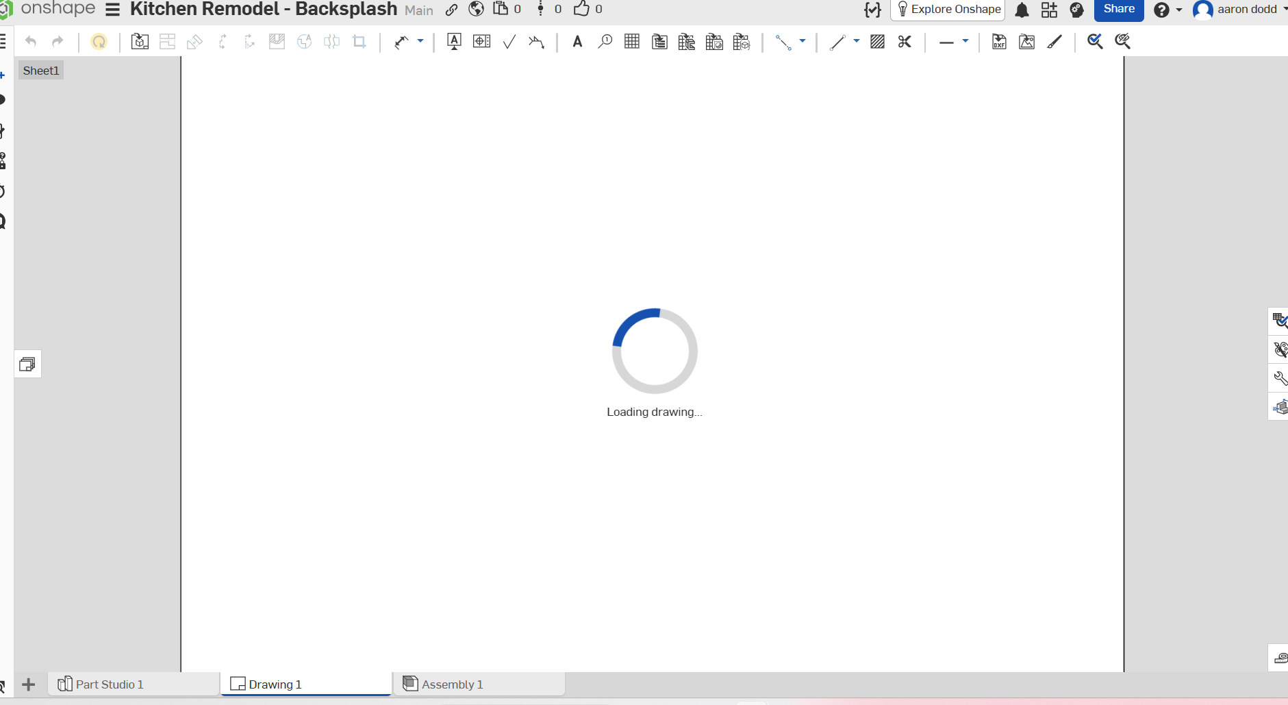

  • aaron_dodd
    aaron_dodd Member Posts: 2 ✭
    I have been having the same issue where everything loads except for drawings. When I go to create the drawing, I just get this loading screen.
