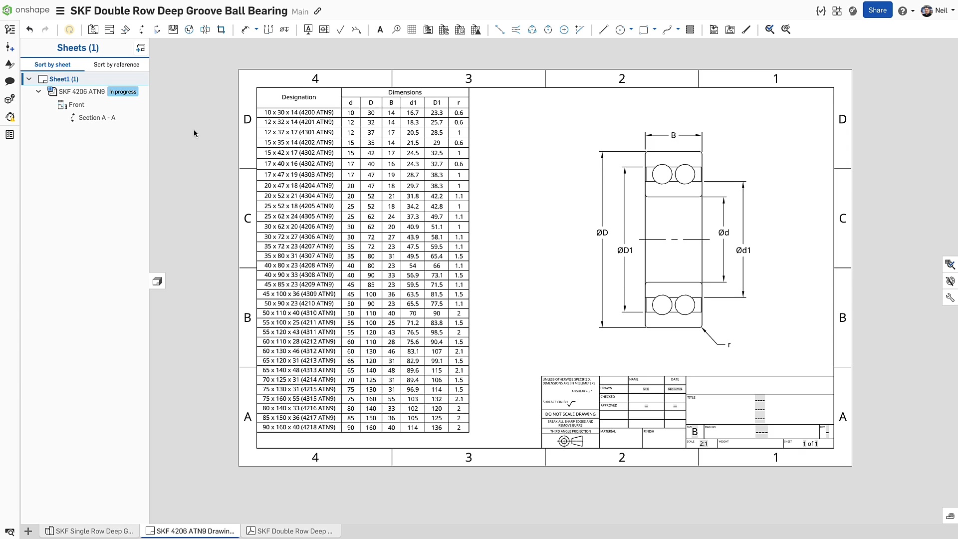

I am trying to add dimensional values from my part into a table in a drawing.
Either by inserting the variable table or individual dimensions.
Can I?

    There are some work arounds for this. Just recently they added the ability to paste from a spreadsheet into a drawing table. So I think it would be possible to copy and paste from a variable table into a drawing (perhaps with a Google sheet as an intermediary?). I haven't tried this. Of course it wouldn't be parametric, but at least you could get the info from one place to another without retyping.

    Yes, you could input the variables one at a time into the Table custom feature which would then keep them up to date. This would be a pain but would work.
    Alternatively, you could keep your variables in Excel or Google sheets then import them as a csv which the table feature can read and create variables for. Then to update, you just right click your csv and select "update" which will prompt you for the new csv file.

    I have confirmed that you can copy and paste using google sheets as an intermediary.
    1st - click on the 3 dots in the upper right of the variable table.
    2nd - paste it into your google sheets.
    3rd - highlight the table in google sheets and Ctrl + C.
    4th - Right click on your drawing and "Paste as Table" or Ctrl + V.
    Note: you do NOT have to change the font in each cell individually. You can left click and drag to select all the cells. Onshape will highlight only the outside of all the selected cells instead of all the boarders of each individual cell. The other thing I found out was that by right clicking on the black dot for the table you can set which corner will snap to other lines or intersections in your drawing. This is useful if you want your table set perfectly in the corner of your Drawing/Schematic.
