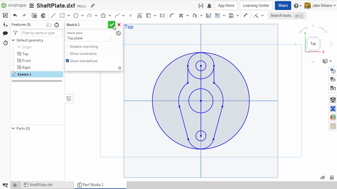

You'll have to open a sketch and import it into that.
When I try that, I get the file name with the ares kudo square cross hair logo thing next to it, and nothing happens when I click on it.

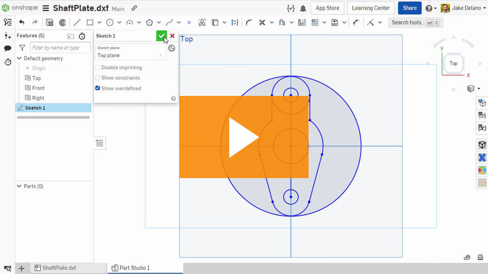

Tech Tip: Turning Your 2D DXF into a 3D Model
