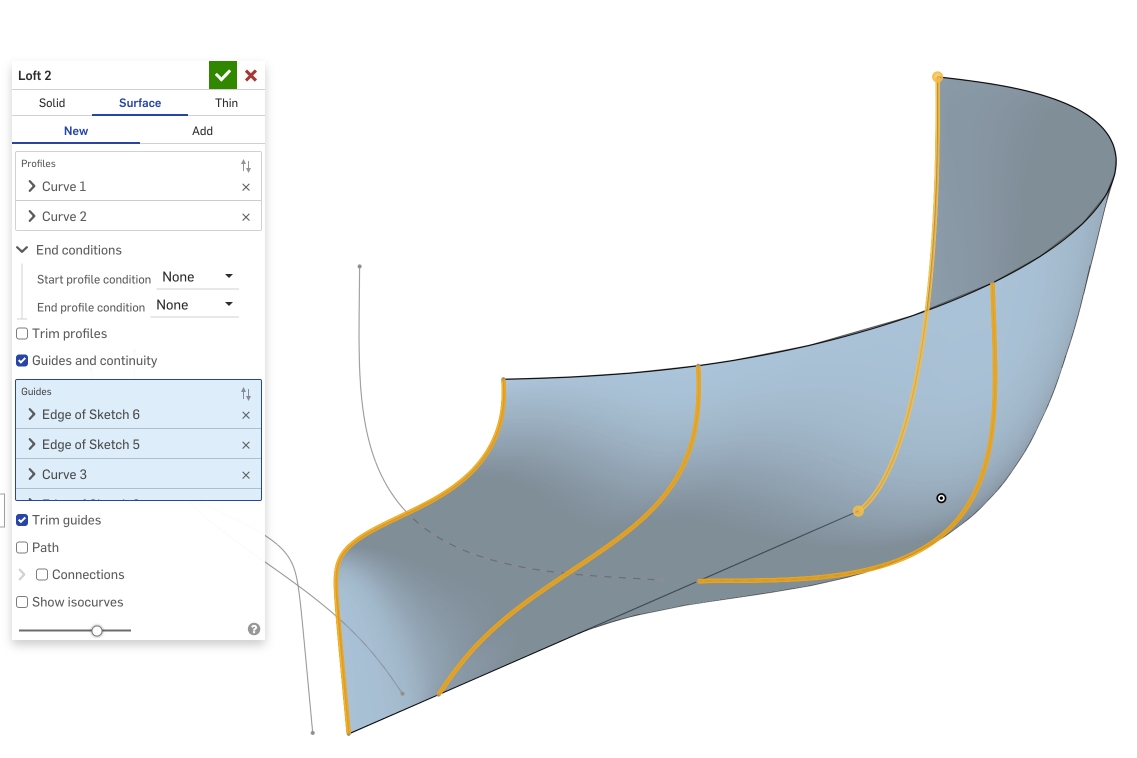

Hi
I am drawing boat hull.
On drawn profiles I used loft function and the result was almost good but on the bottom, created surface goes below all profiles i drawn. I try to use different loft options but it doesn't works.
Do you now what may be a problem here?
https://cad.onshape.com/documents/fbb395d41aeaebe840b50e4e/w/f06a7c8e0809421445065b4b/e/694a5350b9ed7252e2ee1e9e?renderMode=0&uiState=67effea3ce6f4c6359333920
Matt_Shields
Member, Onshape Employees Posts: 930 PRO
A quick fix is to swap the Profiles and Guides. (I also trimmed Curve 1)
it worked, thank you :)
