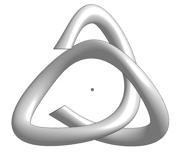

I need to create a continuous loft. ie. it has to end where it started from in a continuous loop. But every time it fails to create the final link. Any ideas please?

    Creating it in two parts will not give the same natural bends. This screenshot shows the shape I want to create (with the missing connection)

    seems like the section of the 'knot' is quite uniform. wouldn't a sweep work?

    I tried doing it in multiple parts but the twists/bends were not that harmonious.

    The sketches are on different planes/levels so I cannot use sweep

    Added 1 3d fit spline through all your circle centers, Added a point to the center of one of the sketch circles (needed this to finish the 3d spline at its starting point). Created the sweep using one sketch circle and the the 3d spline as the path

    @anthony_cassar ….3D Spline…then Sweep your desired profile…
    PS: 3D Spline can really hurt your head, especially without reference points in space to help define them. In this case I used a Feature Script called "Freeform Spline".

    Ah the trefoil knot is a tricky one! Seems like this got solved (and is a good use of Freeform Spline, or the new native Routing Curve feature). Sweep is better than loft here unless you need to vary the cross section.
    To answer your original question though, a closed loft is possible if you use closed guide curves. I do often wish there was just a "Closed loft" button though like the 3D Fit Spline feature.
