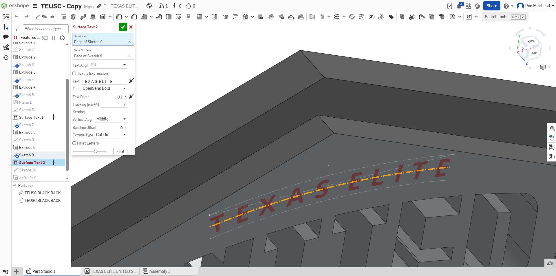

I am unable to Cut Out the surface text. I actually need to cut the test out all the way through. Any help is appreciated..
  • MichaelPascoe
    Try changing the base surface to the actual surface of the part instead if the sketch face. This should allow the feature to find the correct body.
