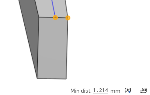

Hi,
I'm applying a draft to a frame.
The draft is applied to two opposite faces and I was expecting that each face would be drafted by the same amount, but they're not.
The frame starts as a 6mm square, the blue line is the frame reference line:
The draft is applied as below, the neutral plane is the opposite end face.
The results are as below:
I'm sure I'm missing something.
Any help appreciated.
Thank you.

  • graham_lock
    graham_lock Member Posts: 277 PRO
    It turns out that the frame reference line had a very slight downward bow near its centre.
    Once this was straightened the draft works as expected.
    Why would such a deviation cause the draft to have an offset?
    Thank you.

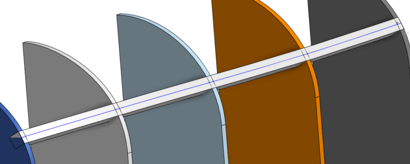

    The problem only occurs if the beam is rotated:
    In my use case the beams are place around the edges of former parts - before the draft is applied all looks fine:
    After the draft is applied:
    The centre line is now distorted.
    If the beam sits at the top pf the formers at 0 deg there is no distortion after the draft.
    Any advice appreciated.
    Thank you.

  • graham_lock
    @_anton and @jelte_steur814, you're both absolutely correct, the blue line is not accurate.
    That line is a 3D Fit Spline generated in Featurescript with vertices at a given % offset along the selected edges of each of the formers.
    The frame is drawn at an angle which is tangent to the selected edge on the first former where the blue line intersects that edge so the rotation is constant throughout the frame,
    If the angle of the beam as viewed from the side is not constant throughout its length, ie maybe it bends down towards the end, then the blue line essentially shifts across the beam as viewed from above leading to the draft offset.
    At least I can see what's happening now!
    Thank you for your help.
