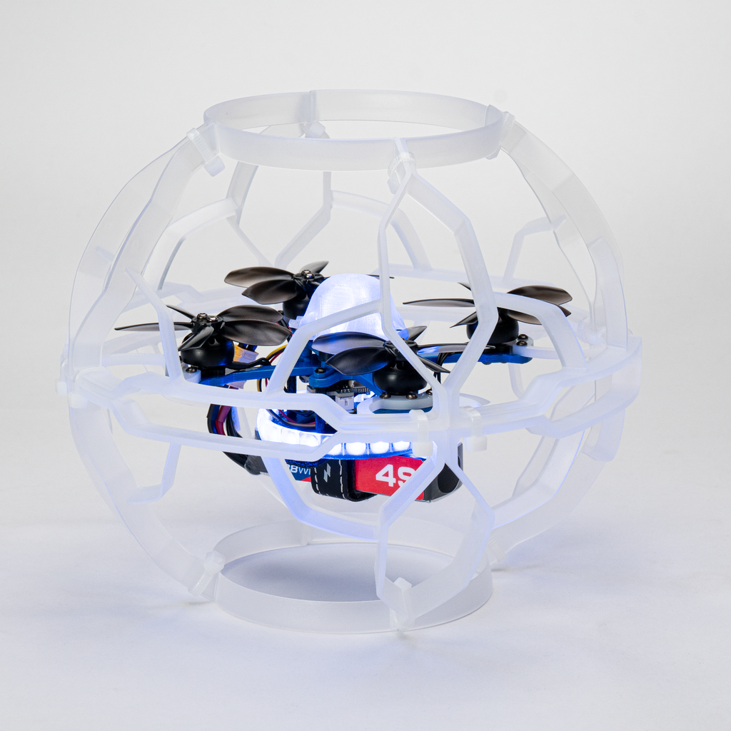

Can I make a spherical drone cage nearly identical to this one?
Luke_Saunders
Member Posts: 2 ✭
Can I make a spherical drone cage nearly identical to this one? I can't figure out how to do this, even if it's possible. I am only trying to make one of the hemispheres. Thanks.
That should be possible. Try making only an eighth of one hemisphre. Then mirror to make it a quarter, then put two in an assembly and do a circular pattern. Just a quick incomplete sample, and possibly the strategy could be optimized when trying a second time:
