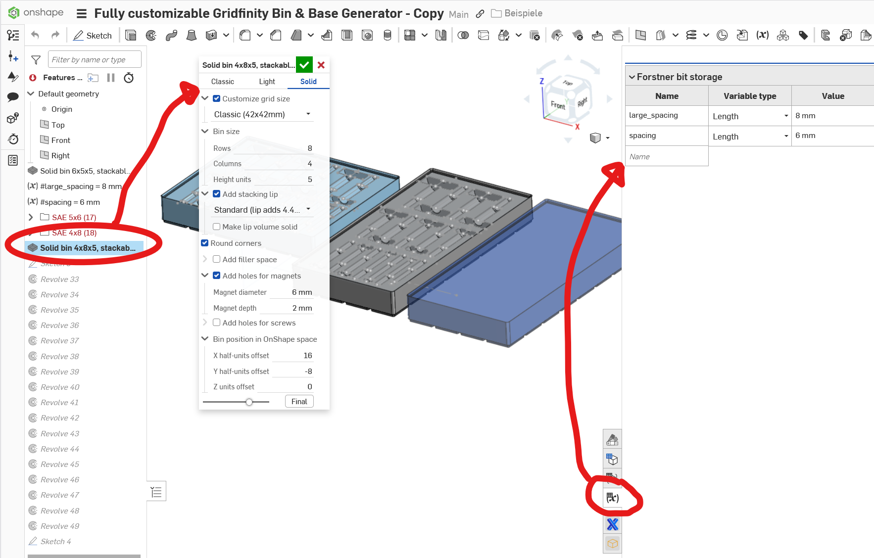

Gridfinity led me to want to customize my "drill drawer" specifically starting with reorganizing my Forstner bit collection which has far outgrown the original wooden case. Once I started exploring Onshape, I quickly found a document titled "Fully customizable Gridfinity Bin & Base Generator" and within it a tab called "Forstner Bit Storage". So far with Gridfinity, I've only managed to print the base grids for two of my drawers. One being for the "Drill Drawer" and the other for "Precision Measurement Tools". I've not created any bins at all. For the most part, I want bins that are customized for individual tools/drill bits as in Forstner bits.
Here's the issue. I don't know how these documents work. How does one go about customizing the "Forstner Bit Storage tab to meet your specific tool size needs? How do I edit the pre-existing sizes? It seems to me there should be some sort of dialog box where I input the variable widths of the different sections of the Forstner bit along its length. I don't have any idea where to find this.

    Hi John,
    there are two places you might want to look at:
    The one on the left is the Feature Script that handles the bin sizes (Look at grid on lower side of bins!) and the other is the variable table that handles the spacing of the bits. Just play around with the values you find there and see what they do if you change them. Always only change one by one, wait for the result! ;0)

  • john_legg
    john_legg Member Posts: 6 ✭
    @martin_kopplow Thank you. I think this is what I'm looking for. I'll try it later today when I have more time to address it. Your help is greatly appreciated regardless of how it turns out. Thank you, Thank you, Thank you!
