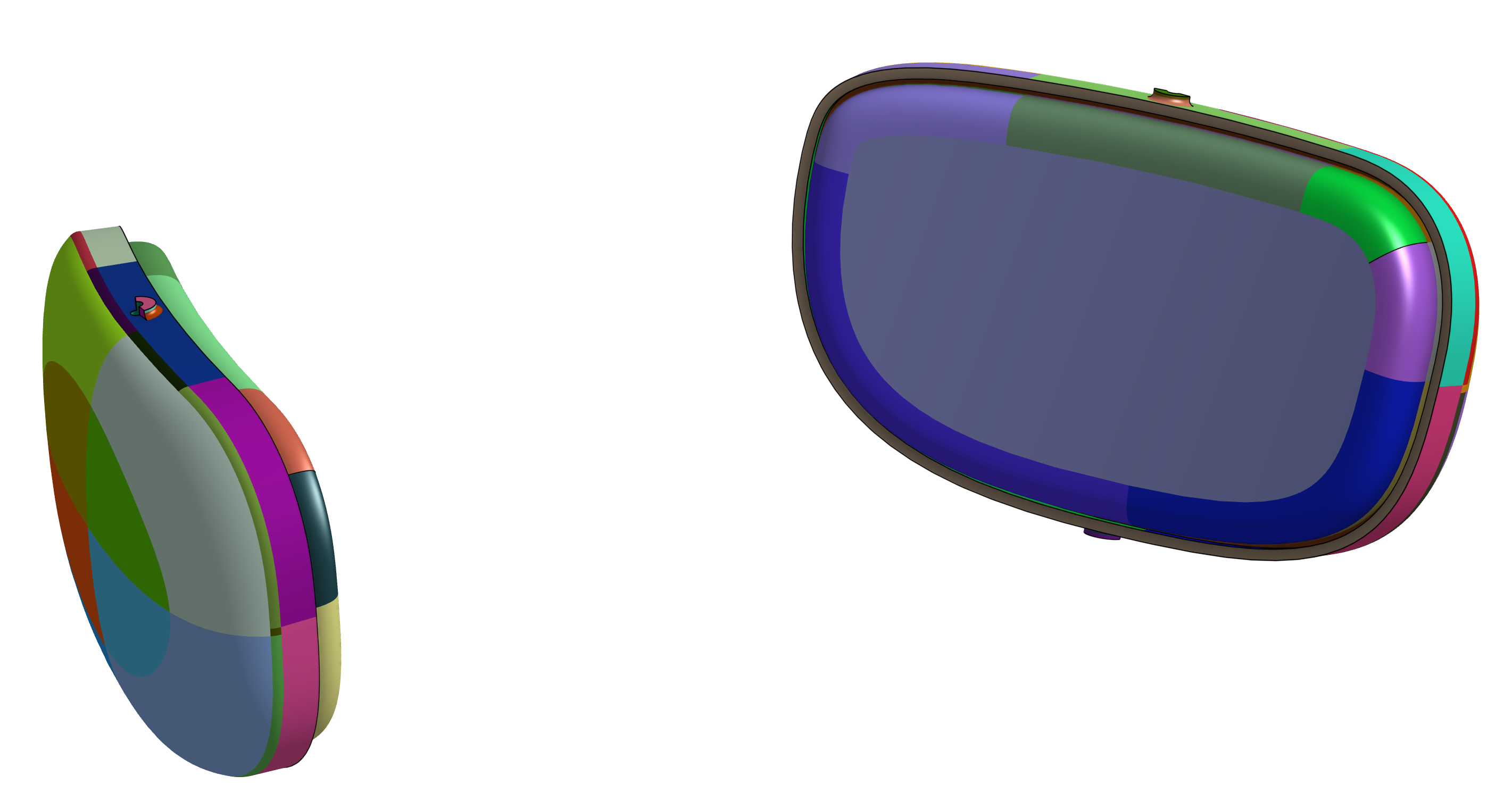

I have found Rainbow Faces from Smart Bench Software to be a great Custom Feature!
https://cad.onshape.com/documents/6c10172a1734b4f178ad78be/w/70765346933e90216a09db4c/e/7c1aed24adff1f95d693043f
Not only do kids love the pretty parts, but it also helps with understanding of drawings and how features show up in different views.

    Very cool. I missed this. I've often wished for more diagnostic shader options for Onshape. This seems like it covers the random one well. Thanks!

    If I could make a request, it would be to try to make the random colors more distinct. I'm sure making every border between different colors high contrast would be a very challenging thing to do algorithmically (kinda like in 2D the 4-color map theorem). At least according to a quick discussion with ChatGPT it sounds like 7 colors for an object which is topologically a sphere, but each hole you add (to make it into a torus) adds a color (a single hole means 8 colors, two holes 9 colors, etc).
    It would help if the palette doesn't include any colors which are close in LAB or HSV or even RGB.
    Here's the beginning of my research if it's of any help: https://chatgpt.com/share/682b7ce8-09b4-8010-bdf1-bb47ea47458c

    Finally got a nudge to take another look at this, I've added a high contrast mode and a red/green colour blind mode.
