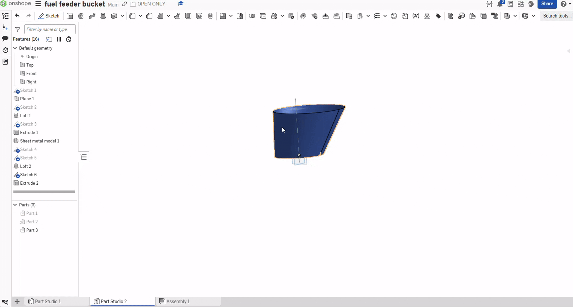

  • Derek_Van_Allen_BD
    edited June 2025
    I'm not one of the devs at Onshape but I've bullied their sheet metal kernel enough to make some educated guesses how things work under the hood. The main barrier to lofted sheet metal is guaranteeing that the seed surfaces defining the sheet metal bodies are developable and zero gaussian curvature underneath. Cylinders are a developable surface because their curvature is inherently parallel to their axis of revolution. Cones are an inherently developable surface because they consist of straight line geometry pointing towards their central axis, but these UV curves are no longer parallel in their unfolded state. Lofted faces don't necessarily carry zero gaussian curvature depending on the inputs used so they need to be evaluated at runtime to check the curvature across the entire surface to determine developability. Or you allow non-zero gaussian curvature but evaluate everything piecewise as the surface flatten tool does, but now your script is computationally insane depending on how granular your simulation is.
    The funny thing is lofted sheet metal technically already is supported if your underlying surfaces have no draft or twist to them. The only first party way to make the geometry is using the extrude option for sheet metal but I've got a script that does a surface extrusion and a replace face on any input body to force label the valid spliney faces as extrusion geometry so the sheet metal convert tool will unfold the parts and give you a flat pattern.
    Geometrically there's no difference between the seed part's faces before the custom face fixer script runs and after, it's just that extrusions have a geometric neutral axis that can be read and trusted implicitly by the sheet metal kernel, where lofted faces need that extra interrogation step.
    The 3d side of the sheet metal engine already just works for the real complicated twisty cases if you can set things up so the feature runs in a single convert step (and disable all geometry checks in your own custom fork of the sheet metal tool), it just fails to do the unfolding stage at the moment.
    As for the demo shown in that tech tip, the piecewise segmented loft approach has its own limitations for faceting. I've attempted to modify another version of someone's custom faceted loft script but that approach can fail in cases where the segments of curves on one side of the loft can't be aligned with like segments on the opposite side and require triangulation instead of a flat parallel extrusion face. This especially happens in offset lofting cases. I never got around to researching fully how to handle those cases, but I imagine the devs encountered a similar hangup and that's why we still have yet to see that tool hit the core feature set.
