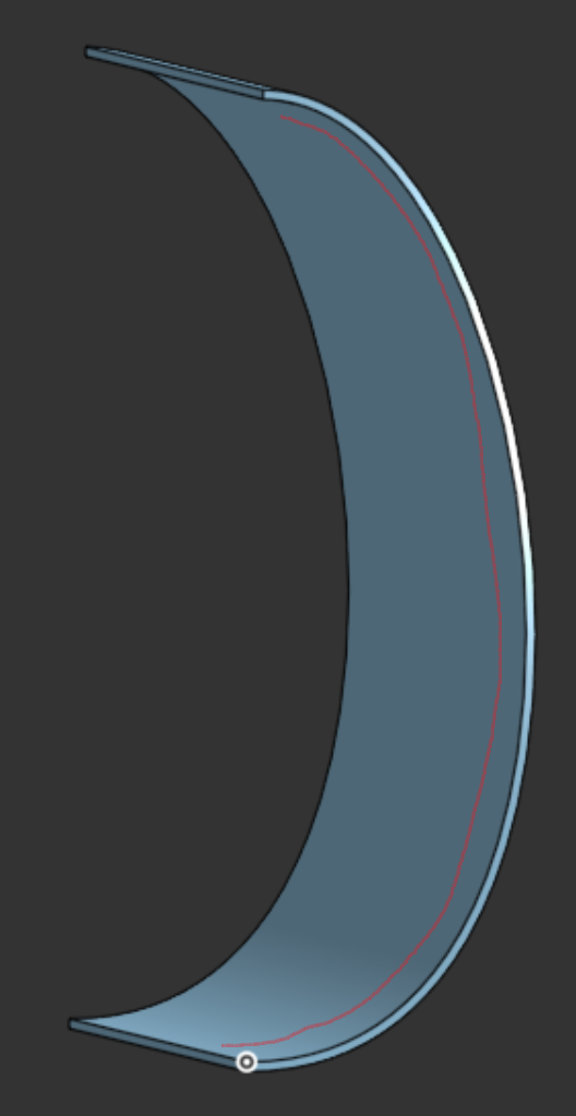

I have a curved part as below:
I want to add strengthening ribs to the inner surface for 3D printing - as depicted by the brilliantly drawn red line!
The part shown will be approximately 1mm thick and the ribs will be of a similar depth / width.
What would be the best way to create those ribs please?
Any help appreciated.
Thank you.
  • robert_scott_jr_
    Sweep?
  • glen_dewsbury
    Examples of sweep.
  • MDesign
    sketch with use edge, and offset that line and connect the ends. then extrude to desired thick.
    there is no best way
