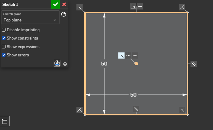

A simple sketch set up using the center point rectangle is showing as undefined. Both sides are have dimensions set as length = 100.0 and height = 60.0. The image attached shows all the constraints. This has been happening on more complex sketches and I can't figure out why. I have re-booted my computer and cleared Chrome but to no avail. I am running Windows 10.

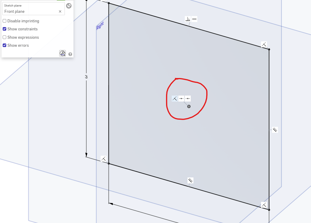

    Looks like you missed the origin at the start of the center point rectangle. As you move the mouse toward the origin a square will appear. If you're in the vicinity of the origin but not close enough it will highlight with out the square.
  • MDesign
    As Glen as pointed out…. Number 1 undefined issues that trip up new users is where is it located. not how big or what angles but where is it located relative to other defined geometry

    Looks like you are missing a constraint to the origin.
