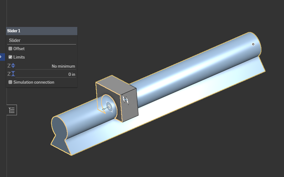

I have a linear rail and carriage sub assembly:
The rail part studio has a configuration variable which sets its length.
The carriage part studio also has a configuration variable which sets its length.
The carriage is mated to the rail with a slider mate.
Is there a way to set the maximum slider distance using the rail length variable and then subtracting the carriage length - i.e. something like #railLength-#carriageLength?
Any help appreciated.
Thank you.
Sorry about that, I had a bit of a brainfart…
Width mate isn't what you want! That will keep the carriage centered. The two mates with one sided limits is the way to go for this. I used a slider on one end a parallel at the other end as it's always best to limit the amount of "over-constraining" (even though two sliders should work).0
Short answer no, but you could do it with two mates: one from either side with only one sided limits.
Actually, never mind, remove the limits and use the newly added width mate!
Thank you - do you have an example of how to set this up?
I'm getting over constrained errors when trying to use a slider mate with a width mate.
Width mate isn't what you want! That will keep the carriage centered. The two mates with one sided limits is the way to go for this. I used a slider on one end a parallel at the other end as it's always best to limit the amount of "over-constraining" (even though two sliders should work).0 -
Thanks Eric, that works well!
