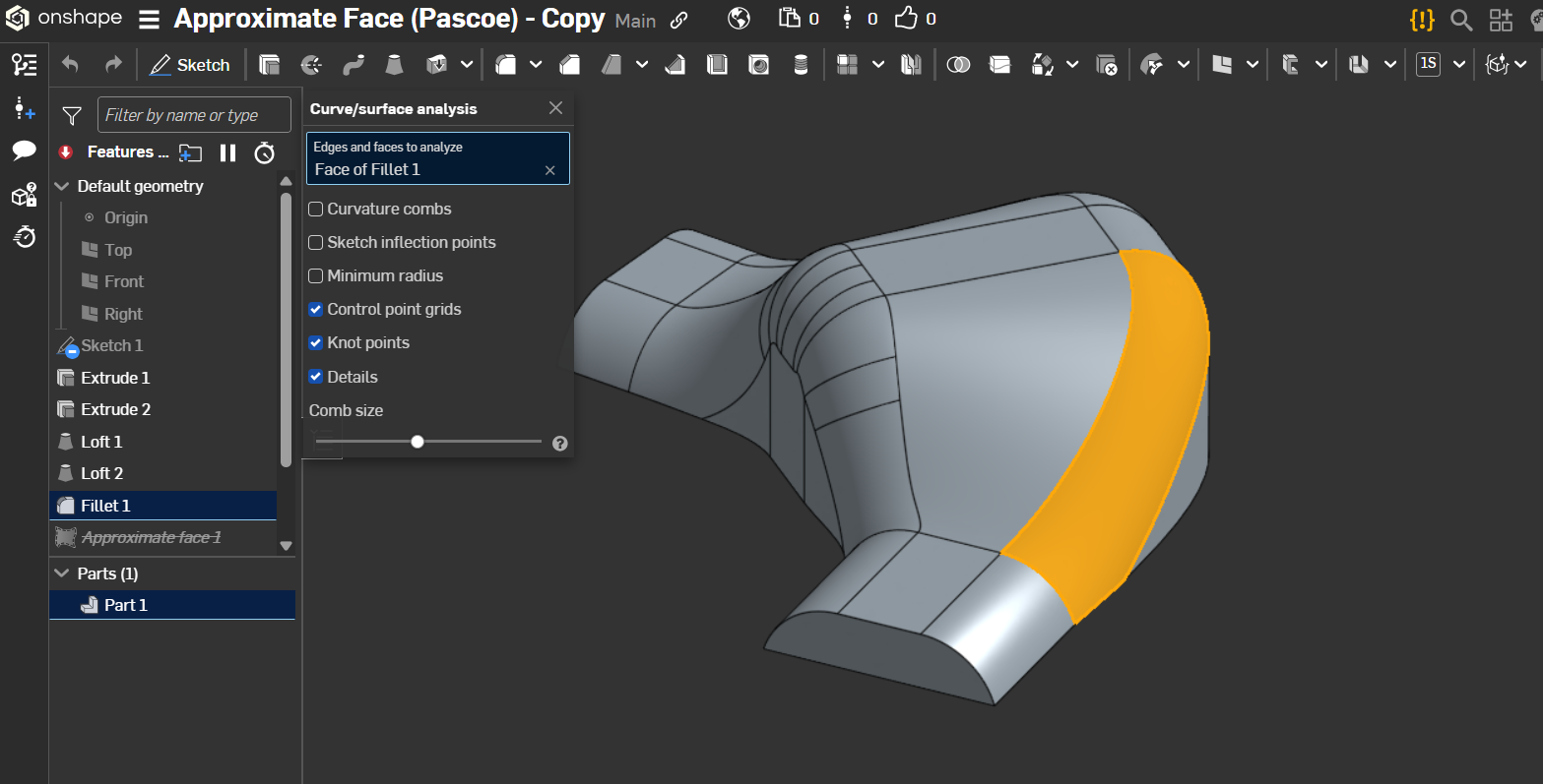

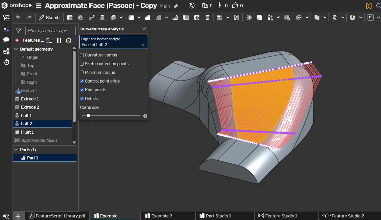

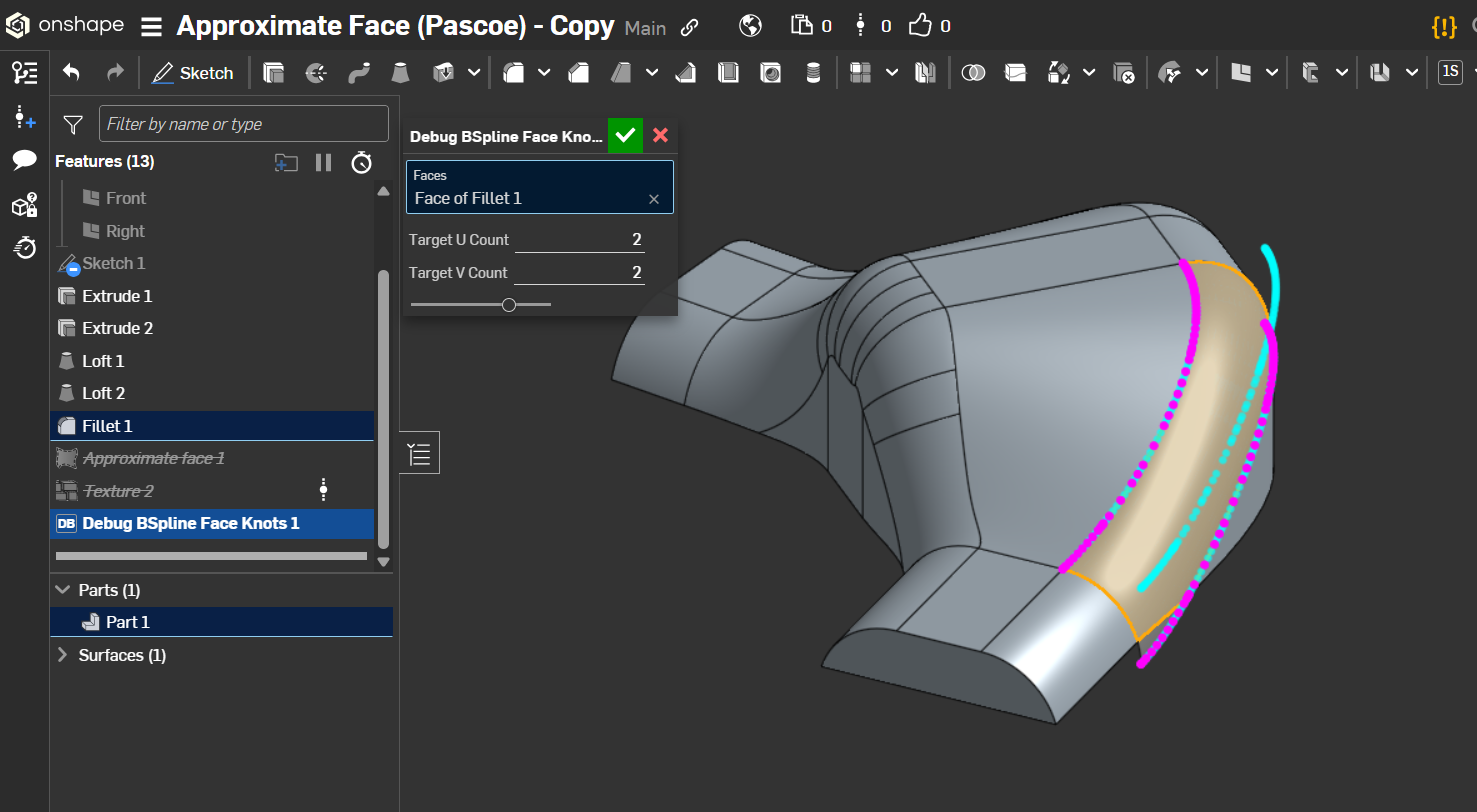

    Found some cases where the new surface analysis tool isn't displaying the control points or knots of the selected face.
    Working fine
    Not working
    One of my custom features seems able to extract these points in the cases where the analysis tool isn't displaying things, might be helpful for diagnostics.
  • PeteYodis
    PeteYodis Moderator, Onshape Employees Posts: 594 image
    @Derek_Van_Allen_BD I've created a support ticket for you. Please share your document with support on that ticket.
  • GregBrown
    @Derek_Van_Allen_BD the new Curve/Surface analysis shows the additional diagnostics only for SPLINE type surfaces and curves. There are a number of other surface types (and they are listed here https://cad.onshape.com/FsDoc/library.html#module-surfacetype.gen.fs ) for which we do not currently show the diagnostic.
    In your case above you have likely used evApproximateBSplineSurface in order to return a true (and approximated) SPLINE surface. We are not doing that approximation in the analysis tool, hence there is nothing to show for the Degree, CPs, Spans.
    This is similarly the case with curves. We only show the diagnostics for SPLINE curves. Somewhat confusingly there are some curve types that look like splines, but are not exactly splines (examples are Intersection curves, Projected curves, to name a couple of examples). In order to "see" their underlying math it is necessary to convert them/reapproximate them. You can do this interactvely with and Edit curve feature, for example, and of course do it programmatically inside a custom feature.
    Let me know if there is more info required!
