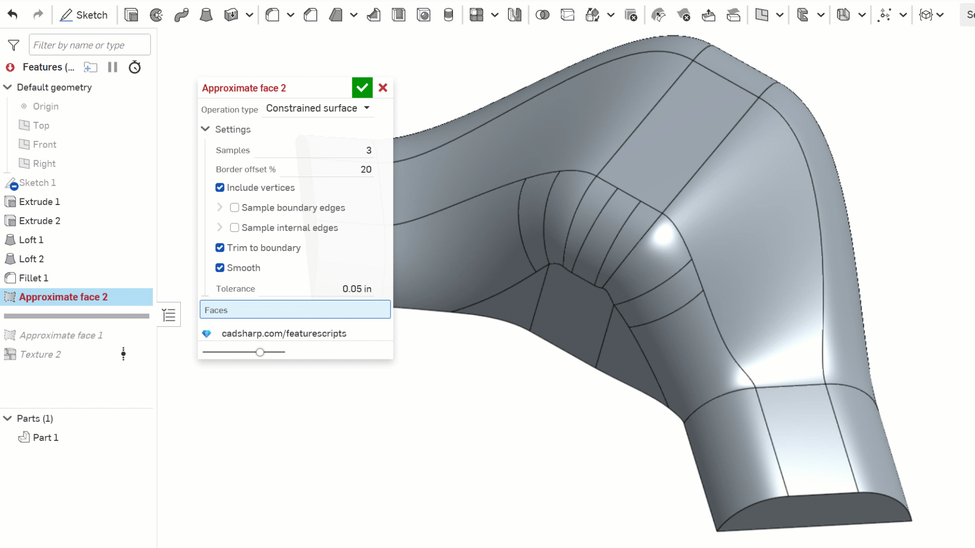

CadsharpSpin.gif Β CADSharpΒ has sponsored a new custom feature:
ApproximateFace.png Approximate Face

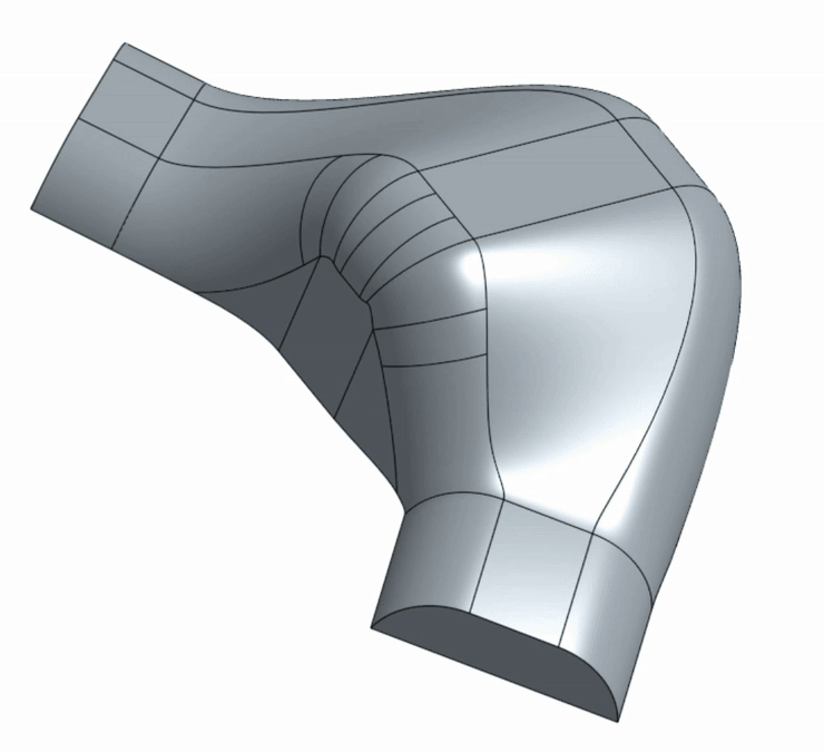

This feature uses Onshape's new constrained surface functionality to re-create an approximation of multiple faces. Useful when working with features like Texture or Attractor Pattern that only allow one input face.
CADSharp Feature Library
⚠️ Need custom apps, tools, or workflows? Reach out to CADSharp, we do this for a living.

    Ahh I see, you slap the faces with a bunch of UV points for the constraining operation. I opted not to do that for my edit surface feature because control point or knot density can vary across the surface and I'm trying to aim for locality to be maintained for later when I make tween surface happen. I wonder if this could be modified to extract knots and use those for the constrain instead.

    It's similar to @EvanReese's drape surface, except instead of raycasting to the entity, it grabs the uv points from the selected faces.

    Yes I love the simplicity of it! Faster to use, and compute too, I'm sure (though I've not tested). I'll probably reach for it first over Drape Surface and see if it gives me a uv grid I like. If not, I'll use Drape Surface, which is more work, but more control.
