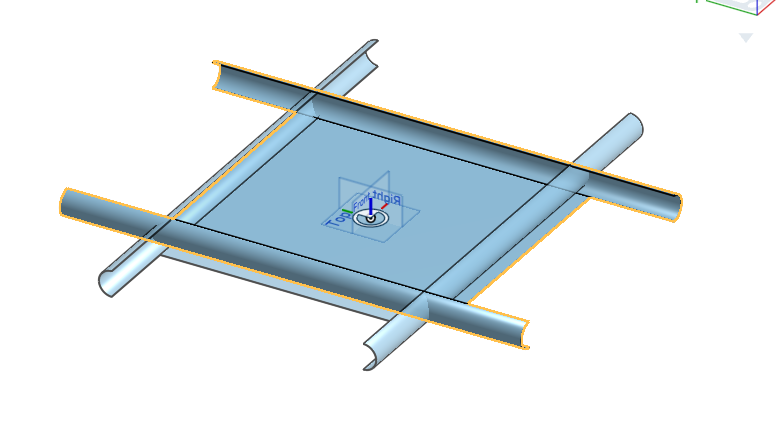

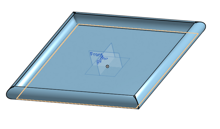

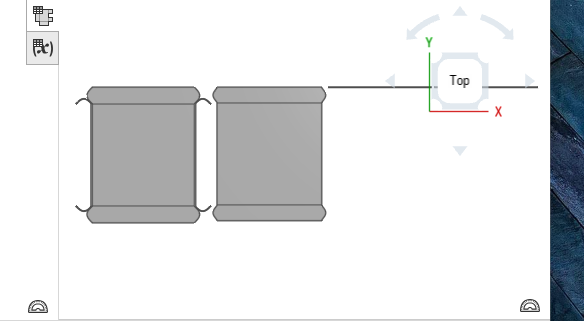

Im trying to creat a sheet metal mold for a concrete slab, the slab has rounded edges along the outside. I want to make a 4 piece mold that connect at 45 degree angles. What is a good method to draw the curved edges of the mold so that i can use the sheet metal tool to get the flattened dimensions? As you can see the way i made the rounded edges from an extrude and then trim the extending parts (with an extrude set to remove till next) didn't result in a clean corner. The resulting sheet metal flat view also didn't come out how i wanted it too.
May it is possible to design a piece like this but it will not be possible to create a piece in this way. even in progressive stamping it would be difficult.
Think about a split somewhere

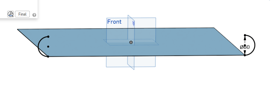

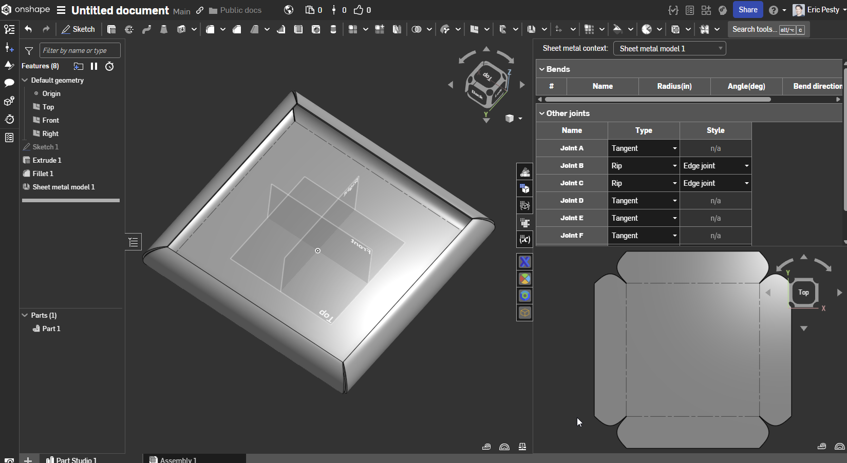

As @dirk_van_der_vaart said this might be hard to make but you can model it easily like this:
https://cad.onshape.com/documents/ec7c90893bd97bfc6d8b6152/w/6c8ee8bb48923930500e3857/e/f2a07a30ddeb98af3019356b?renderMode=0&tangentEdgeStyle=1&rightPanel=sheetMetalPanel&uiState=687826ed6535956d20de71250 -

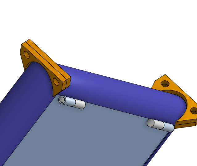

Here is another thought with hinged sides to release an flanged corners to hold corners,
