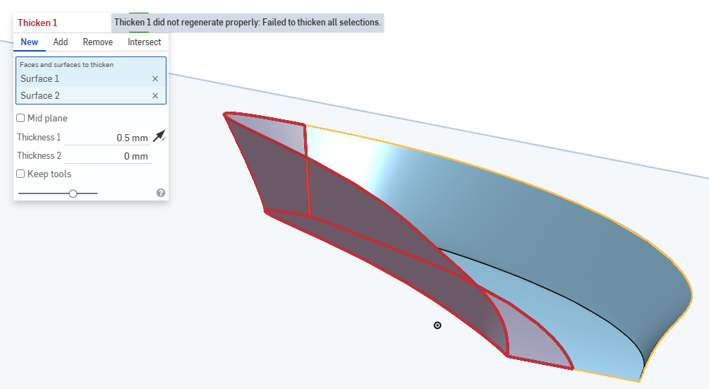

I am trying to create a spoon-like shape with a thickened loft surfaces however no matter what I try I cannot get the thicken to generate. I don't think there are any sharp corners or self intersecting surfaces but I can't work it out.

    Document failed to load for version. Resource does not exist, or you do not have permission to access it.
    Did you make it public?
    can you thicken surface 1 or 2 separately?
  • MDesign
    0.5 mm is asking for too much considering the current curvature quality and small size of the original surfaces. Can you share the doc so that it can be copied for further inspection.
