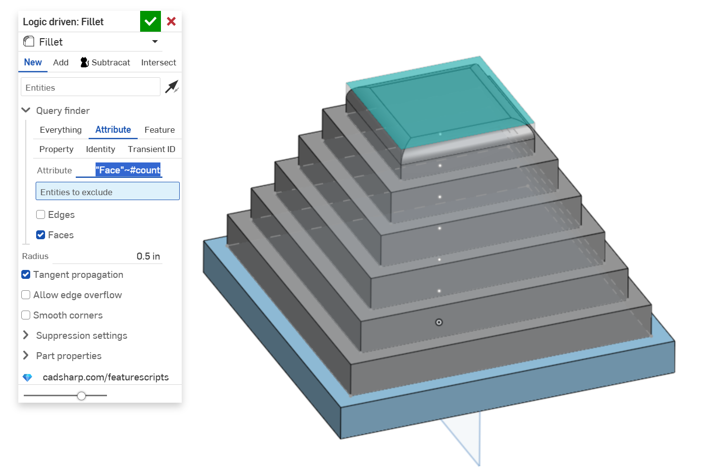

If I have a feature pattern that builds (add) a larger object - think of stacked bricks to form a tower, I can add new features to the last instance of that pattern - a hole in the last brick. But if I change the number of instances, that falls apart.
Is there a way to build upon the last generic instance of a pattern?
  • MichaelPascoeMichaelPascoe Member Posts: 2,814 PRO
    What kind of features are you trying to apply to the last instance?
    You can do this using the OppositeDirection.png Query finder paired with LogicDrivenFeature.png Logic driven feature.
    https://cad.onshape.com/documents/6c320907d96fc10d8a2791e5/w/3e39e152bfe89f607cffbd6e/e/6f5eb2d6124b0349532e4d3…
    RENDERCAD
  • Matt_ShieldsMatt_Shields Member, Onshape Employees Posts: 943 PRO
    Another option is to use a variable to drive the pattern and the location of the particular feature.
    Yet another way, would be to do two separate patterns one for the first and last instance, that way they never change and then another for all the instances in the middle.

    Currently, I'm indeed using a calculation to locate the end of the pattern array. I'm using the measured sidelength of the object after the pattern. I use that lenght to position an offset-plane, upon which I can start creating additional geometry, and then boolean the array and the extra geometry together. But it feels a bit like a hack.
    I'll definitely look into the Logic driver and Query finder, since I like programming.
