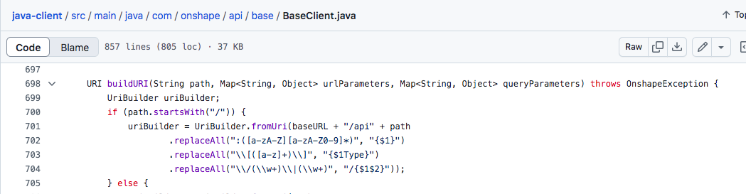

I try to write an app to generate a model by adding FeatureScript-Features to a PartStudio.
I am able to add a feature to a PartStudio using the method at Glassworks. However I get an exception (com.onshape.api.exceptions.OnshapeException: Error processing json) trying to do the same via Java client.

  • eduard_martoveduard_martov Member Posts: 5
    So, it looks like the problem is the outdated logic for building URI in the Java client (class BaseClient, method buildURI). In the line 701 "/api" should be replaced by "/api/v12".
    I suppose, Java client is not supported, isn't it?

  • Caden_ArmstrongCaden_Armstrong Member Posts: 448 PRO
    /api/ or /api/v12 both work.
    Specifying the specific version can give you a different input/output format.
    What body/json are you sending to the API? That is most likely the problem. Getting the body right with adding features can be tricky, especially depending on the feature.

    Hi Caden, thank you for your response!
    Here is the content of my log in both cases:
    Fail
    Success
