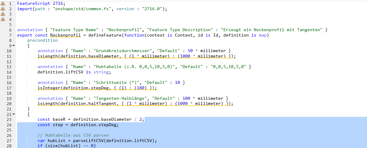

Having trouble to finis my cam profile script,
dominc_bürgi
dominc_bürgi Member Posts: 2 ✭✭
here the start of the code:

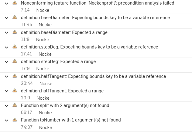

and the errors:
  • Matt_Shields
    I think you want something like:
    annotation { "Name" : "Grundkreisdurchmesser" }
    isLength(definition.baseDiameter, { (millimeter): [1, 50, 1000] } as LengthBoundSpec);
