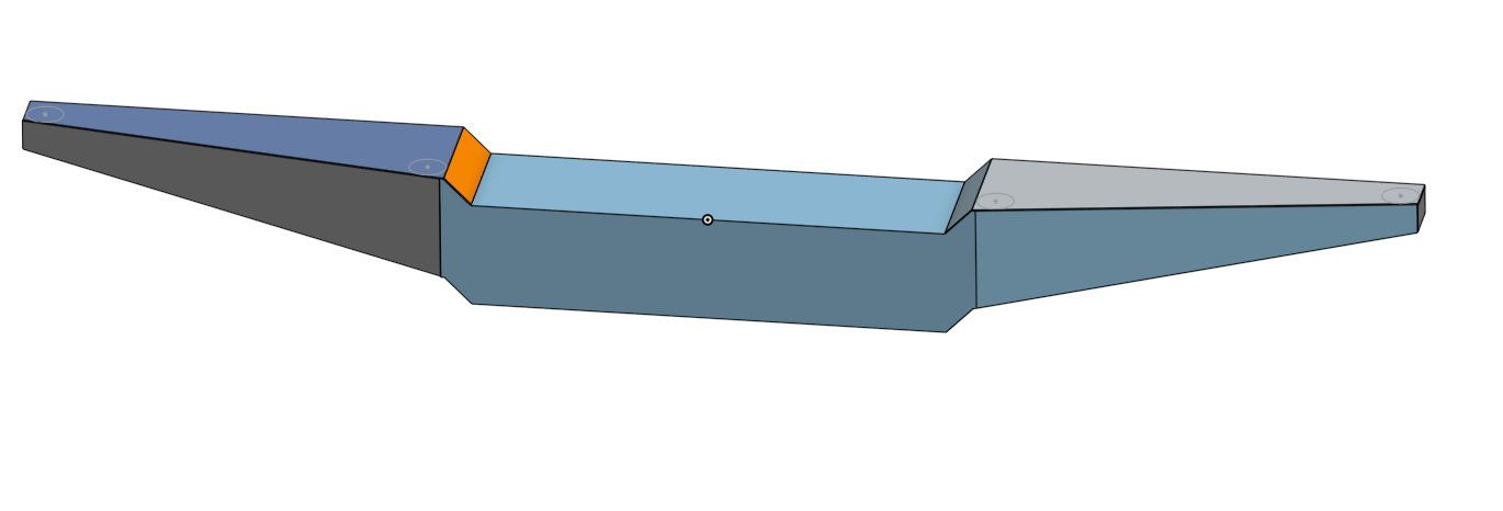

I am having a problem where i cant make a path for my hoops of the bull bar. I am trying to make a path starting a one cylinder that goes up and then curves to the left and goes straight then curves down and meets the other cylinder. I am having trouble find the right plane to start the sketch on as the line wont go up it will only let me draw on the face of the extruded object or the planes. the cylinders are set back as they would be on a bull bar and I wouldnt like to move them.
is there away around this?
This is the first part

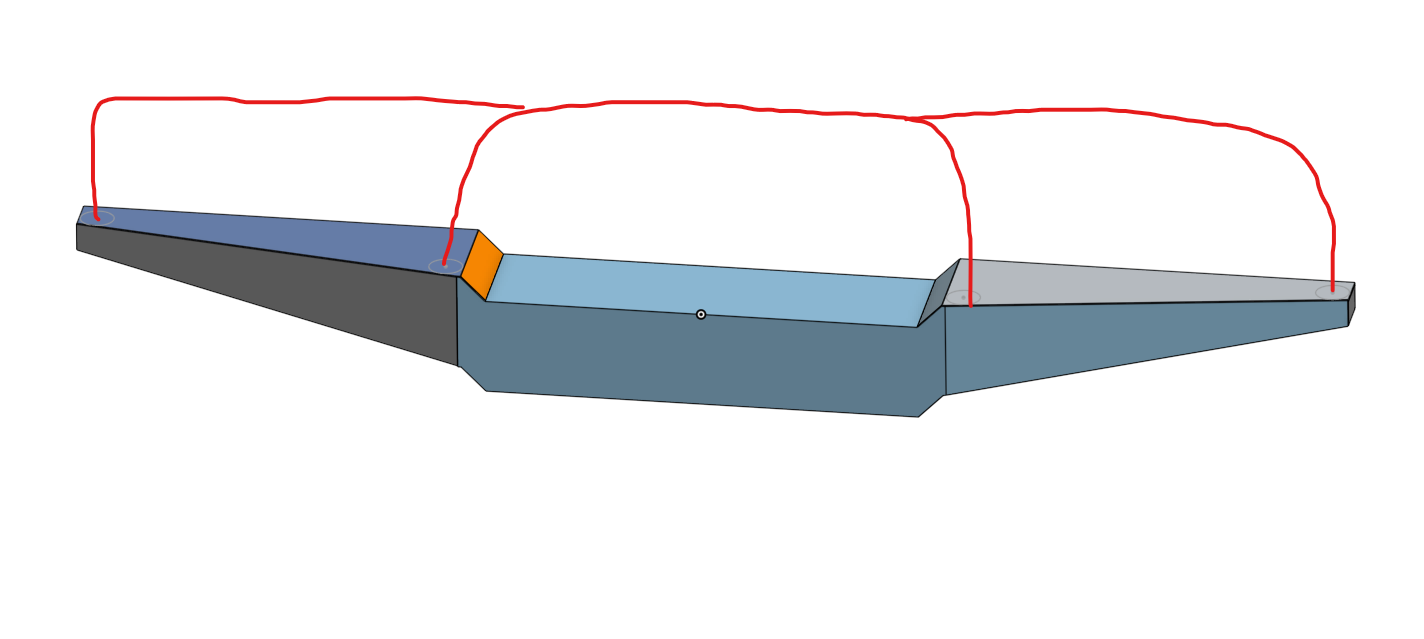

This is the hoop that i would like to make. (The middle hoop is the one im stuck on, but i would also like to make the tow on thet side, but need to make the middle one first)

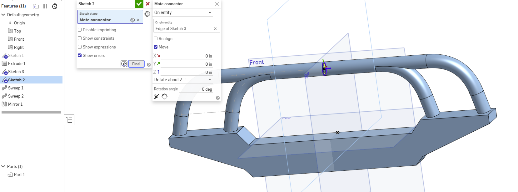

yes that is quite similar. what did you do to get the hoops coming up?

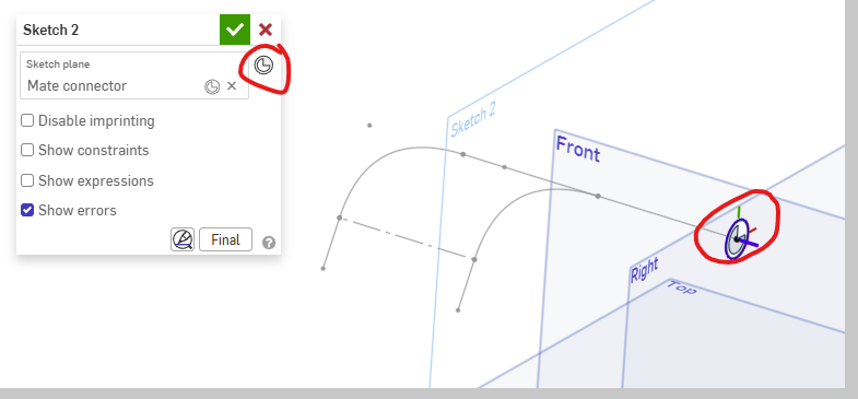

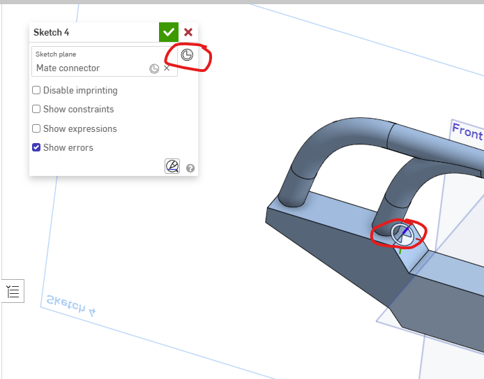

I used mate connectors for sketch planes.
