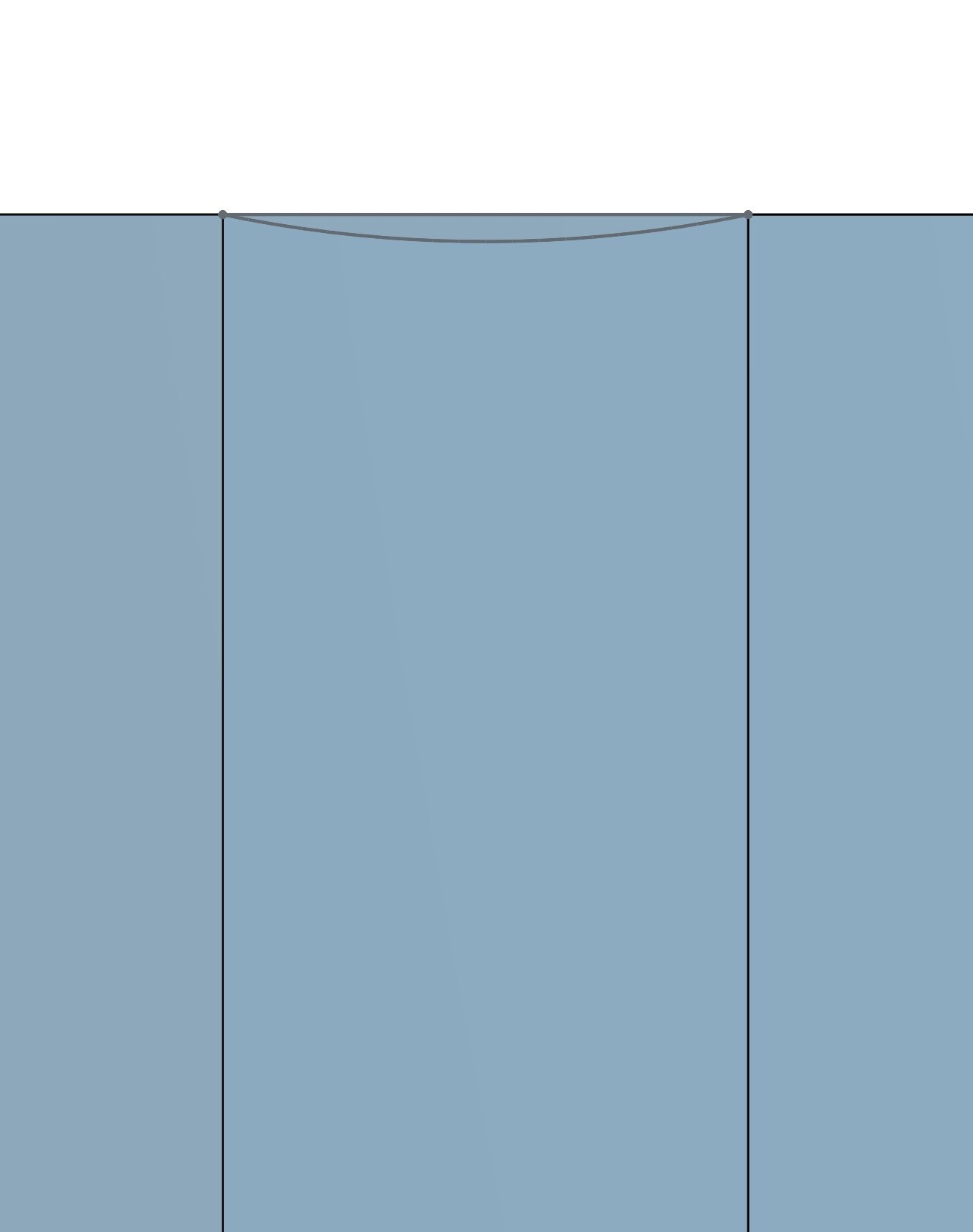

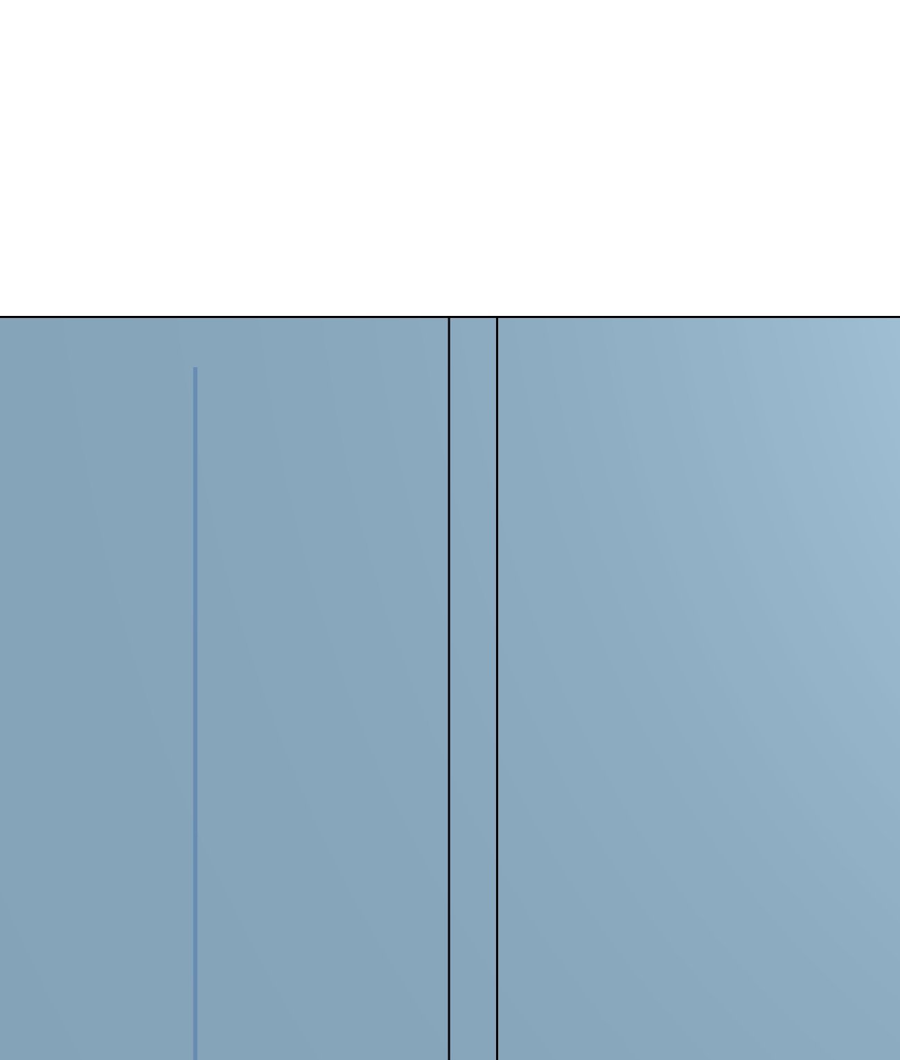

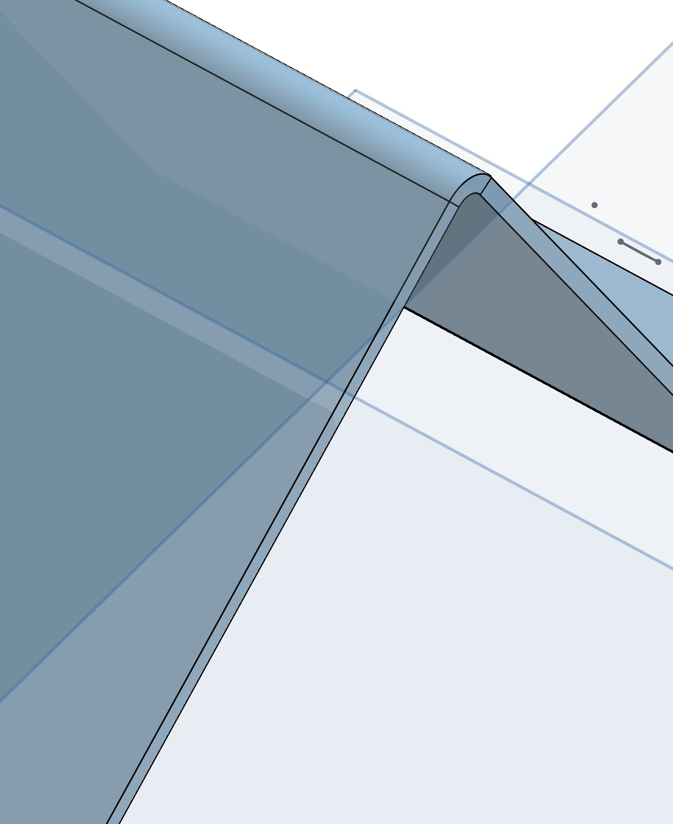

Hello,Is there a way to automatically cut away the burr that forms along the bend line on the sheet metal part directly in CAD?Here are 3 images.

    It is possible, but there is not a feature currently made for it that I'm aware of. (Someone correct me if you know of one.)
    To do this you would use FeatureScript and make a custom feature.
    If this is for commercial work, you could have CADSharp write it for you.
    If this is personal or you want to do it yourself, here are the resources for learning FeatureScript:
    FeatureScript Fundamentals by Onshape
    FeatureScript Video Tutorials by CADSharp
