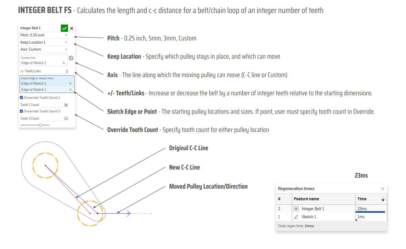

New Custom Feature: Integer Belt (published)
joshtargo
joshtargo Member Posts: 679 EDU
Calculates the actual c-c distance and integer-tooth belt/chain size needed for two given pulleys.
Produces a sketch, and a named 2D curve.
